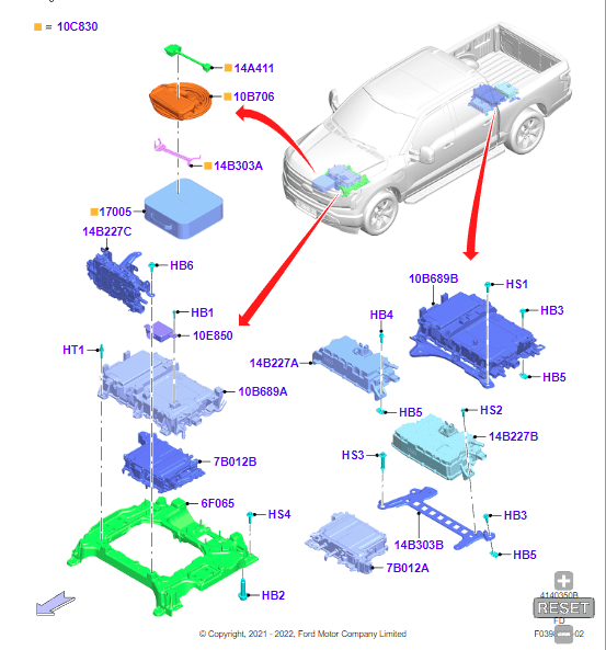

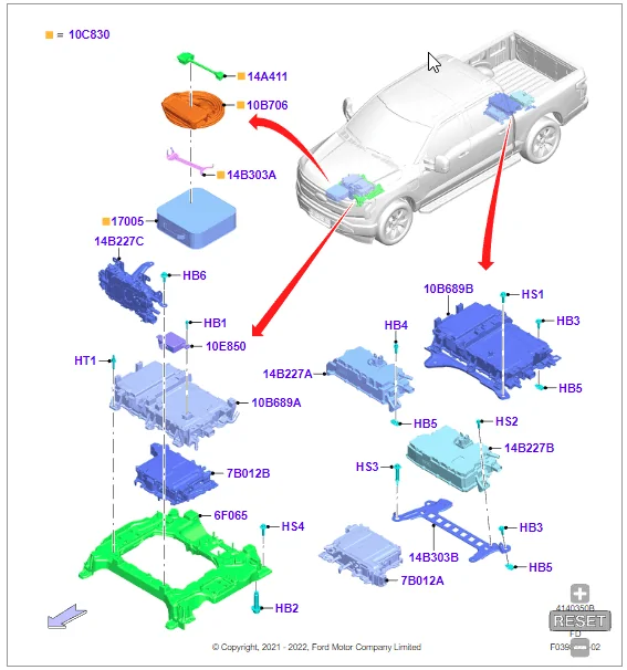

It appears to be Part #: NL3Z14290M
https://parts.ford.com/shop/en/us/e...ck-control-module-wiring-harness-p-nl3z14290m
I'm able to see this diagram on parts.ford.com, but for the life of me I can't figure out how to go from the base # 14289A to the actual part # NL3Z14290M. My parts guy at the dealer said he also doesn't know why they don't really make it easy to do this for owners on parts.ford.com, but once the dealer provided me the part # I could plug it in and see that the description does make sense:
Drive Motor Battery Pack Control Module Wiring Harness
Power Inverter #3. Single Phase Charger - 145"/3675MM Wheelbase.
I could try to figure out the coolant hoses this way too ,but I honestly think

I could try to figure out the coolant hoses this way too ,but I honestly think the coolant hoses can be done with normal automotive plumbing methods but will need an example vehicle to go by to know where they tee in. We need someone with this Pro Power Onboard 9.6kW to be able to reference, take pics, have their bed pulled off :). Preferably a Pro or XLT.
I'm guessing the 7.2kW, 240V inverter is referred to as "Power Inverter #3", so I searched this and found this:
Part #: NL3Z7F120A
https://parts.ford.com/shop/en/us/engine/engine-cooling/engine-coolant-pipe-tube-p-nl3z7f120a
Part #: NL3Z8D121B
https://parts.ford.com/shop/en/us/engine/engine-cooling/engine-coolant-pipe-hose-inlet-p-nl3z8d121b

So, mr2urbo004 and I have been exploring what it would take to add the 240V,7.2kW inverter to the lightning to upgrade to the "Pro Power Onboard 9.6kW"
Ref: https://www.f150gen14.com/forum/threads/7-2-progen-missing.10245/page-2
I'm curious if anyone has done this or explored it for the Lightning? The truck I've used as an AB Config reference for all the OEM mods I've done has at some point caused my APIM to think I have it when I really don't. This causes a weird display on the Pro Power screen:
Last night was the first night we've been without grid power since I've had the truck almost a year. I hooked the truck up to my house to power fridge, lights, nat-gas continuous hot water, etc. I am suddenly wanting the 240V pro power to run my AC :) Not an issue for me for heat as my furnace is nat-gas, but sleeping hot sucks. So, here is my window sticker.
2022 XLT SR EG 311A:
Here is the 2022 XLT SR EG 312A:
Is my terminology correct here in that we should be referencing this equipment as "Pro Power Onboard Standard" and "Pro Power Onboard 9.6kW" related to the Lightning, even though we are really only adding a 7.2kW,240V inverter to upgrade to the 9.6kW? My OCD is not compatible with Ford and terminology a lot of the times. Aside from any wires or coolant hookup it looks like only 2 parts are needed for this upgrade are:
The Inverter, $1,574.05:
Part #: NL3Z-14B227-B
https://parts.ford.com/shop/en/us/electrical/control-modules/hybrid-voltage-converter-p-nl3z14b227b

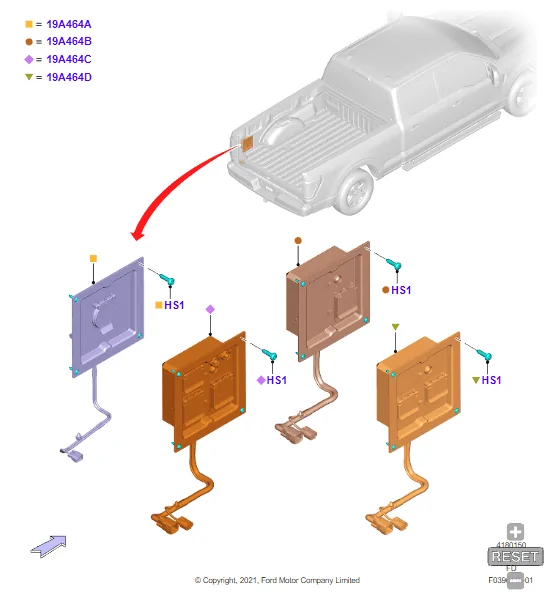

The Plug Panel, $284.70:
Part #: NL3Z-19A464-B
https://parts.ford.com/shop/en/us/e...ry-power-outlet-battery-charger-p-nl3z19a464b

Do you think this is the inverter.
NL3Z-14G649-C)
Factory OEM Ford Hybrid Voltage Converter - NL3Z-14G649-C Part Number - OEM Ford Fitment - 2022-2023 Ford F-150 Lightning
It said it is module 3 and for the lightning.

This is what i got from OEMFORDPARTSDIRECT.com
NL3Z-14B227-B - 7-10 days to our facility
NL3Z-19A464-C IS NOW NL3Z-19A464-D 7-10 days out
NL3Z-14G649-C - 7-10 days out.
W505435S442
W716498S450
W721627S450L
W719952S450L

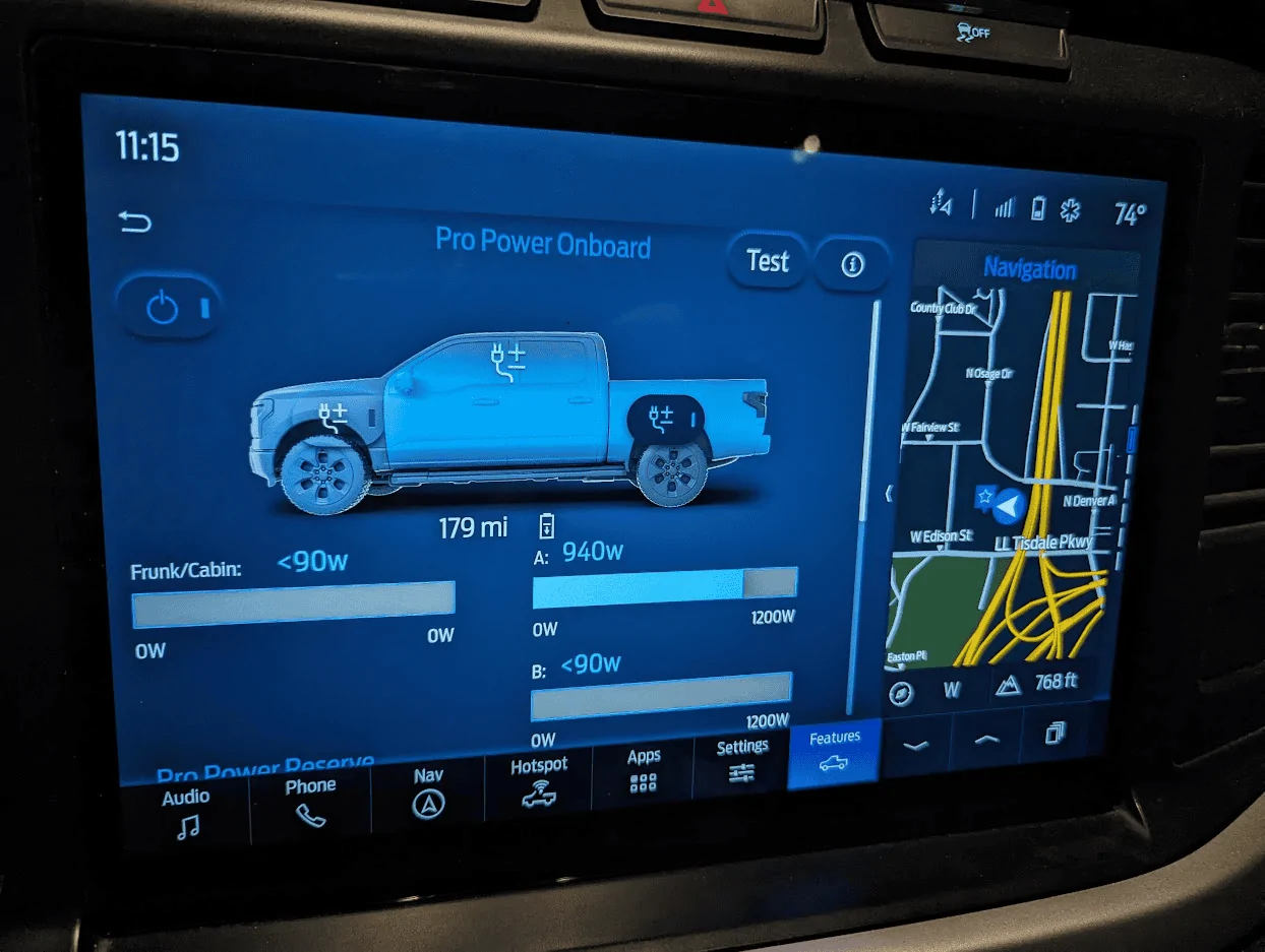

How much watts were you doing? Going to power the house with the 20amp using 5-20p to l14-30.
I was using, at times, most all of the 7,200 watts available, under the 30 amp 240v outlet in the bed... even tripping the truck's 'internal resetable breaker' once... I reset it and the power continued.
I tried using my 20 amp 240v mini-split air condtioner, and the fridge, freezer, house fans, tvs, and even the microwave, all at the same time, as well as turning off the mini-split and turning on the Main house 30amp 240v air conditioner system for a while - just as a test.
This is when the truck's breaker tripped - and when I realized why, it made sense - my HOT TUB had come on during that time - and even though it's on a simple 20amp 120v outlet, it was enough to 'exceed' the amperage, at least on one side of the 240v power of the truck.
Works great - it's simple. I can't believe the cost and aggravation so many are going to in order to have a 'whole house automatic' system... doesn't make sense to me... but, that's o.k.
[/QUOT
I was able to power most of my house outlets to lights and 3 fridge and almost 90% of the house except for Microwave and AC. But it does pop the breaker on the truck once or 2 times a day using the 20amp outlet.
