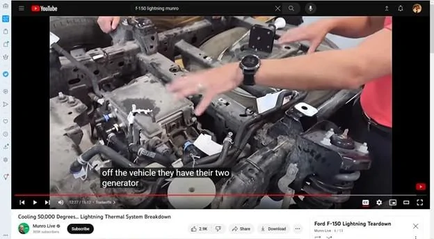

Hey, I just found a Munro video that seems to show the cooling line connections for the Pro Power voltage converters/inverters. It's at about 12:28 in this video on the cooling system:
I've read about the guy who bought the truck that was supposed to include the 7.2kW second inverter, but came without it and him being told that there were only two parts needed, the inverter and the receptacle panel in the bed. It makes sense from the electrical point of view that the connectors might already be there, but I don't see how the coolant lines shown in the video could possibly be there. It would probably be possible to jerry-rig something, but I imagine each of those pre-shaped insulated rubber lines and each connector has its own part number. I was getting really close to ordering these parts, taking my bed off and making the electrical connections, but the coolant lines are making me nervous again. Here's a still from the video probably showing the 7.2 kW inverter.
Ford F-150 Lightning Installing Pro Power Onboard 9.6kW Inverter - OEM Coolant Lines cropped
I was able to find one line that attached to the front (2.4kW) voltage converter. It's Part Number: NL3Z8D012A. But I can't begin to guess which of the hoses in the diagram for rear coolant lines in a single charger truck might connect to the rear voltage converter. There seem to be a lot more hoses in the video still than in the parts diagram.
https://parts.lakelandford.com/a/Fo...ide/_52014_10833657/Hoses--lines/MH22054.html
It should be and out from the 2.4k and a T for. Both in and out for both inverter. That way it both get cool the same time.
I agree that's what should be involved, but I'm not finding part numbers that go with all those lines. I'd probably get a better sense of how the lines could be Jerry-rigged if I took the bed off, but I can't do that until our other car gets back from the shop or my wife will kill me.
