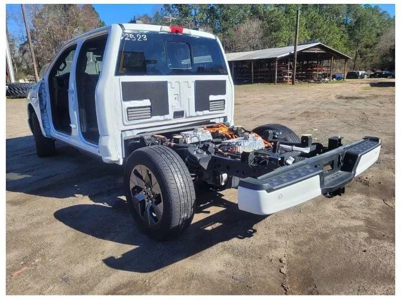

Realistically, it would be great to have pictures of the coolant lines leading to and from the 7.2kW inverter and what they connect to. In the best of all possible worlds, I'd want those, pictures of the orange high voltage line leading to that inverter, and pictures of part numbers for both coolant lines, the fittings those lines connect to (likely some sort of tee), and the high voltage connector. The realistic part alone would be great and probably a that's necessary.
Probaby some junk yard has these truck and has the bed removed. That would be a good start in getting the parts too.

Junk yard lightnings aren't really a thing yet. Ones being sold by copart are going for too high prices to sit in a salvage yard.
