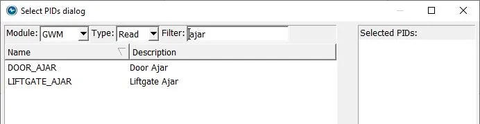

Here is my FORScan
RGTM - Rear Gate/Trunk Module
Bus: MSCAN2
Part number: MU5T-14B673-AF
Calibration level: MU5T-14B673-AF
Strategy : MU5T-14C121-AE
Livinitup's Spreadsheet has an entry for it but no tab or info. Just shows it's address is 755 and not update-able.
Ford F-150 Lightning Is there a way to get the BED LIGHT to come on when you open the tailgate? 1732748307667-qn
I checked my AB from Motorcraft and no data for 755 on my truck. I can check with FORSCan later this week.
