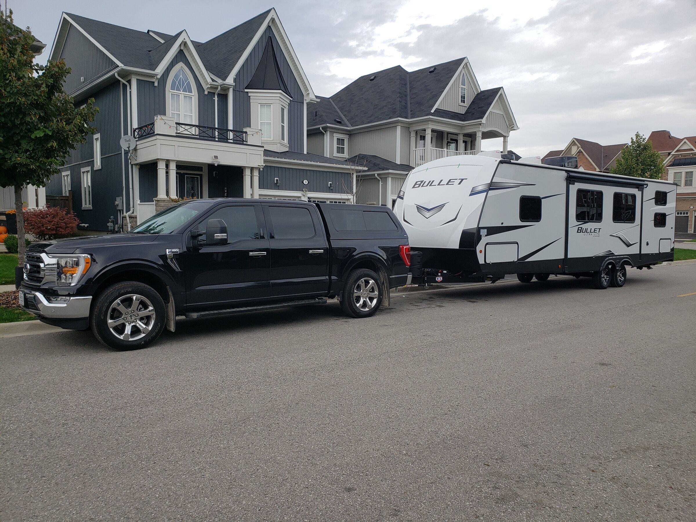

I have driven in both. Max tow and not, I don't notice any difference in ride.
My truck is only 2 weeks old and just got back from our first tow.
Here is the setup I have, absolutely love the copilot assist 2.0 even when trailering. Good luck with your order.
XLT, 3.5 eco, Supercrew, 4x4, 5 1/2 box, Agate Black, 302a, XTR (chrome pkg), 360 camera, max trailer tow, tow mirrors, tailgate step, power adjustable pedals, B&O sound, Co-pilot assist 2.0, 2kw pro power.
In October we upgraded our trailer. Only took it out for 3 trips before putting her away for winter. Ride was great and didn't notice any significant difference in the ride. I just have to remember to take wider turns. Old trailer was like turning with our snowmobile trailer, not anymore. ?
That’s great to know! I have a 2022 Lariat Powerboost with Max Tow on order.
Would you be able to provide stats on your new trailer?
Actual length / Loaded weight / Tongue weight
thanks!

cghall77
Dec 11, 2020
416
Whitby, Canada
thanks!
Dry 6100lbs
Hitch 700lbs
Length 33'6"
Using the Equal-i-zer hitch for 10,000lbs. Like the tow module for the pro-trailer. Also currently using the Haloview MC7109 but its not mean for a trailer this long, pulled it off our Roo 183. Going to upgrade to

Dry 6100lbs
Hitch 700lbs
Length 33'6"
Haloview 7 Inch 720P Wireless Range Dominator System RD7 Plus
Is 33'6 hitch to bumper?

Dry 6100lbs
Hitch 700lbs
Length 33'6"
Thanks!! I have a very similar setup. 26’ actual (20’ by model) on the Equalizer. Hitch runs a little heavier unloaded but actually reduces some loaded. I have the Haloview as well with both backup and side view cameras, but it does start to lose connectivity at full speed so I can imagine another 7.5ft could make the standard Haloview problematic.
