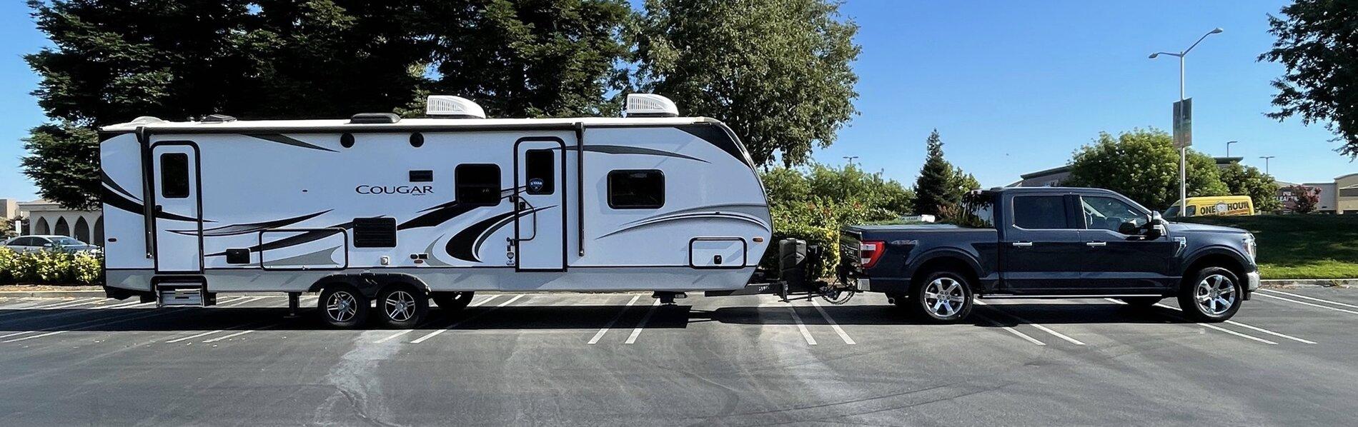

KR 601A, 3.5L EB, Tow Mirrors, 4x4 (not FX), Co-pilot Assist, ProPower 2kW = 1536 payload
Keystone Cougar 29BHS (34') 7800#, 900# Tongue (per CAT Scales)
Do you have the factory Class IV hitch or did you have to upgrade to a Class V?

Thanks for posting all of the trailer info! I have a similar setup (26' / 7,000 # / 800 # Tongue) and am trying to decide between the 3.5 EB and PowerBoost and Max Tow or Standard Tow. I wanted a PB but I think that's cutting the payload too close for comfort. Any regrets with your setup?
