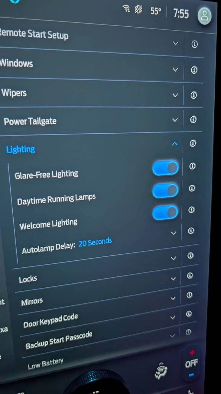

I used the programming in the main sticky on page one. However not only is it not working, as I'm still getting flashed with the high beams on and I don't see any dark shadowings occur with oncoming vehicle. But my headlights have dynamic swiveling. After the programming, I also did a recalibration for the adaptive headlights as suggested on one of the last pages of that thread. After looking through SYNC I noticed I have a toggle switch for Glare Free.. did I turn this into my SYNC or was this in a recent update?
Any suggestions?

The changes you made to the APIM were in part turning on the switch.
do you get a white A on your dash when the high beams are on?
also make sure your center camera is not obsteucted

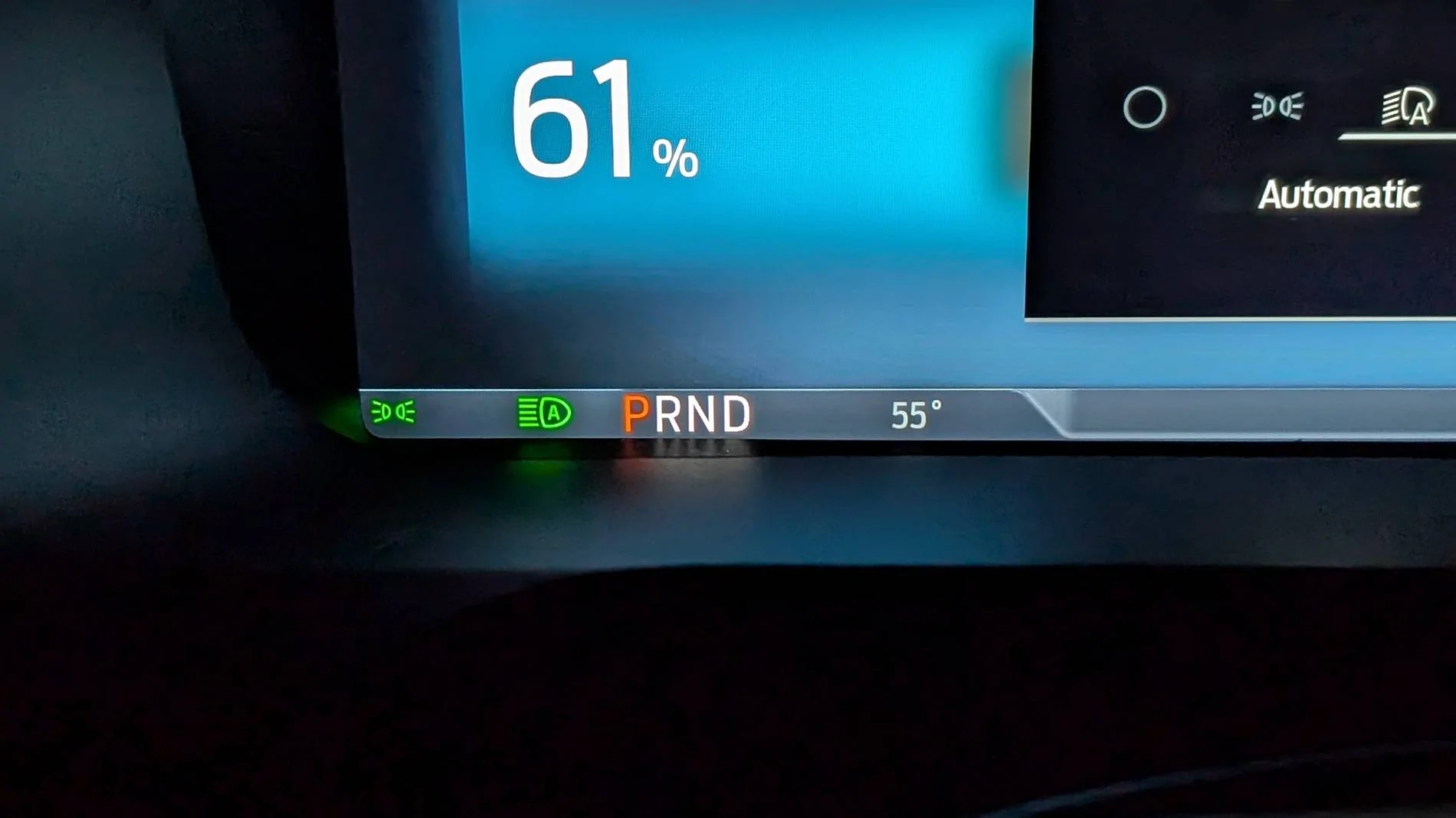

No I don't get any "A" when high beams are on. I get a green "A" when in Auto mode. I have to check all the codes tomorrow. What concerns me is I lost the dynamic swivel.
Sorry, the Green "A" is the proper one for glare free, not white, that is normal on/off auto high beam. Yours is also a weird distance from the light icon in the bottom left.
Make sure it is on the A when driving, the blue high beam is straight high beam, not glare free.
When I had codes I also lost the swirling lights and that also disabled the glare free.
