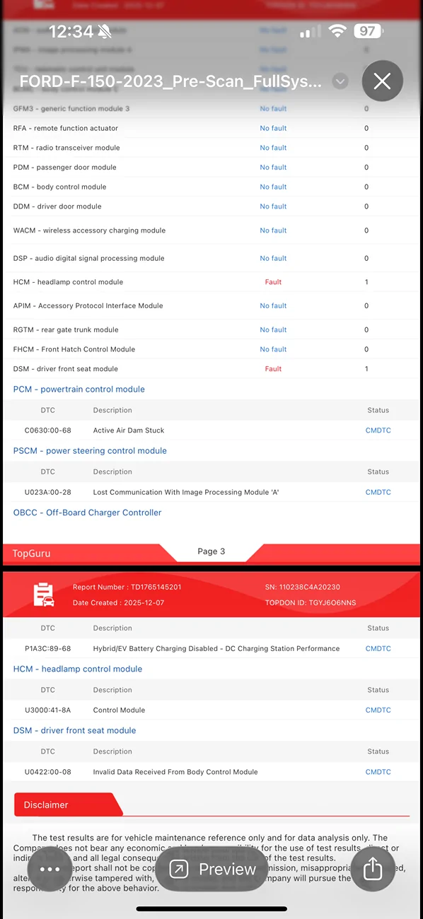

HornetRaider
Abe
Oct 29, 2025
DFW
2023 Lariat ER
I think I posted this earlier but I had the green icon and the toggle for several months and my glare free was not working. I had missed one change and had a DTC in the HCM. I went back through every change until I found the error and now they are working perfectly.
I think there was an early post that had the error in it and that is what I used initially. Check for any DTCs and be sure you are using the settings at the top of the Forscan Version 2 thread and verify that you didn’t miss any.
I pulled codes and do have a fault in the HCM. Was yours similar to what I’m seeing?

carys98
Cary
Jan 15, 2022
910
1,482
Raleigh, NC
2023 Lightning Lariat SR
Retired EE
I don’t remember the code but it was listed as a checksum error. The HSM settings are a little different from the others. Every line in the as-built has a checksum, it’s the two dashes on the end that Forscan will calculate for you. In the HCM section the line 734-11-01 is a separate checksum for the whole module. I think I had missed the last 1 on the 734-03-02 line but I’m not certain.
