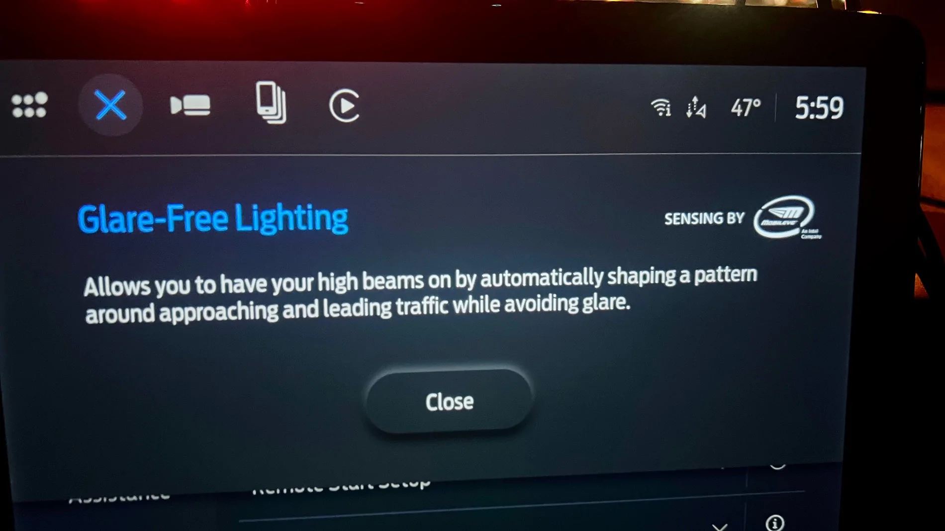

Just enabled this using FORScan and thought it wasn’t working - but then remembered a Sync reset is needed - works like a dream!
Surprised to see “Sensing by MobilEye an Intel Company” We have MobilEye on our work trucks, too.
Interesting that yours didnt' work until sync reset. Did you have the glare free toggle and green icon in your dash before you reset sync? Or did that only show up after you reset your sync?
I haven't reset my sync, but I had the toggle come on in my vehicle settings and icon show up in dash. I may try resetting sync. I've been paying extra close attention to my headlights when going above 34+mph on dimly lit roads and am really not noticing anything...
I may also go back through Forscan and triple check everything. I would think if the toggle in vehicle settings and icon in dash is showing that it was done correctly, but maybe I'm wrong.
I had the toggle and the green icon for almost a year with a checksum error in the headlight module that kept it from working correctly. I went back through all of the settings and found one error and now it works perfectly.
I didn’t see the toggle, so I double-checked all the entries I made in FORScan, then tried the Synch reset and then finally saw the toggle.
3,269
4,760
A Sync reset isn't mandatory but as mentioned in the FORScan guide, several restarts may be needed. I added that note because several members reported it. I personally did not have to do a reset.
Similar (or the same?) is an APIM reboot (see post #2). May help get the functionality without restarting several times.
Glare free involves several modules besides the APIM/Sync and IPC/Dash screen. Definitely double check your values. Also see the Operation Guide I cobbled together and added pictures to from the Canadian Owners Manual.
