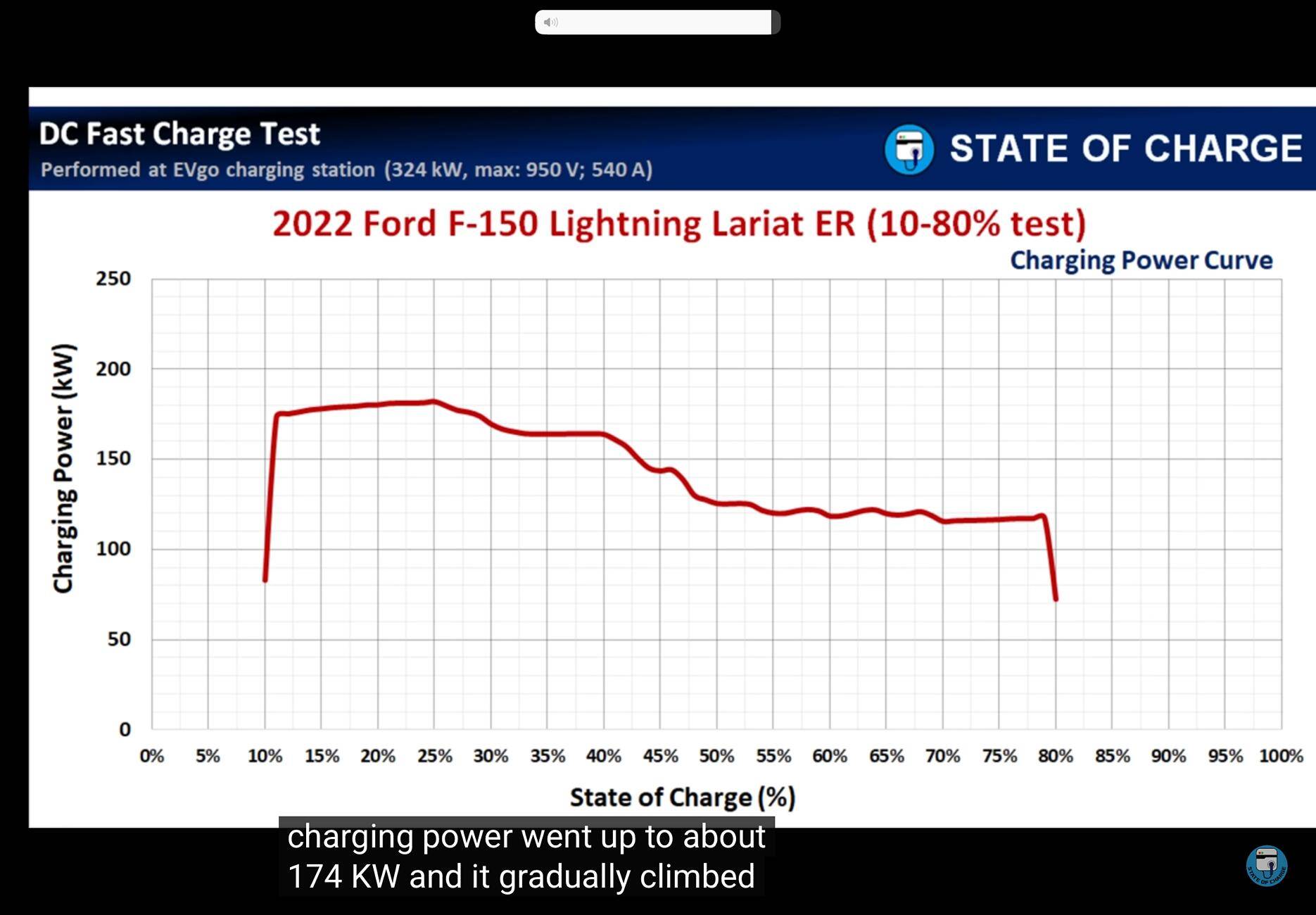

90% is when fast charging ends unless you override.
Exactly this. Lightning charges pretty well up to 80 percent, then drops to almost 60kW. It will stop at 90 percent unless you override and tell it to charge to 100 percent. At 90 it is charging at less than 30kW.

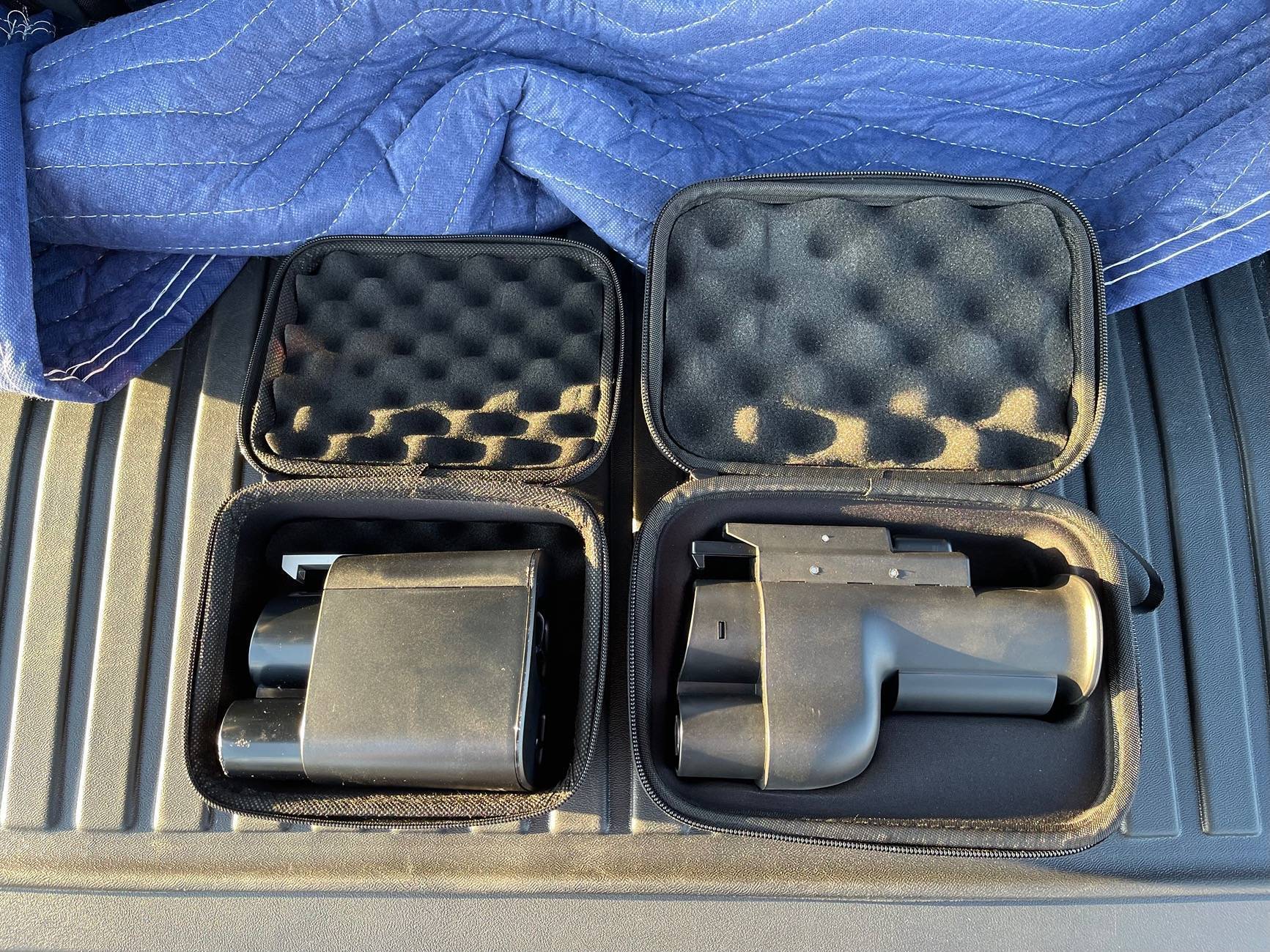

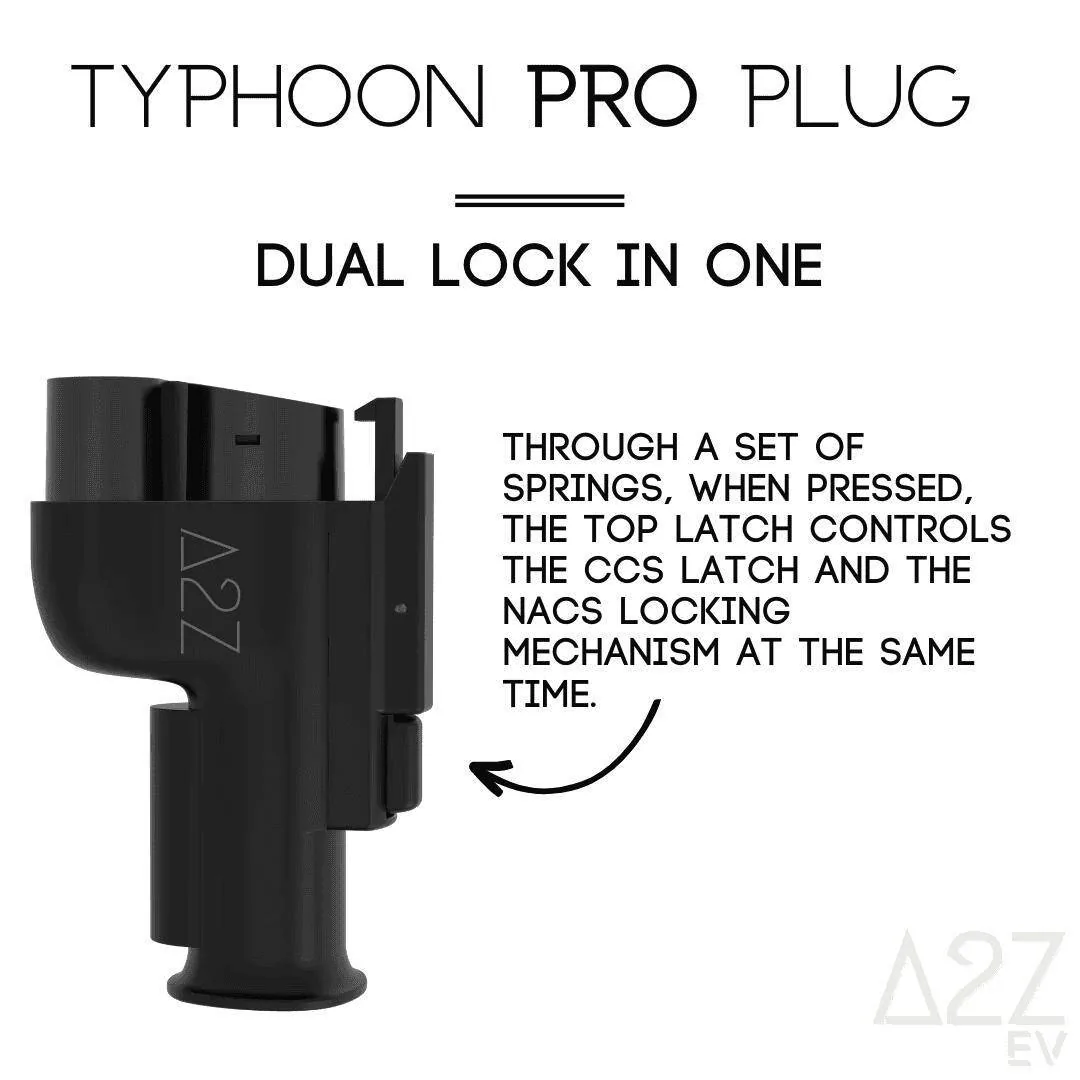

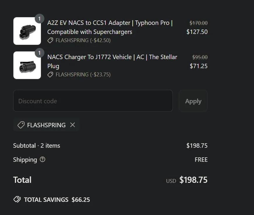

Craig, Do yourself a favor and buy a Tesla Fast Supercharger charger adapter. It makes road trips much easier since the reliability of Tesla Superchargers are the gold standard. You can buy it directly from Ford at https://www.ford.com/support/how-to...ng/how-do-i-get-a-fast-charging-adapter-nacs/
Alternatively the A2Z adapter is a good one. https://a2zevshop.com/ They also have a Level 2 NACS that you should buy for Tesla destination chargers
Definitely getting a Tesla adapter ASAP! I think there was only about two points along the way where this would have made a difference, but that would have made a pretty big difference in route/time usage.

Thanks for the heads-up on the Charging app/infotainment. I'll go see if I can find that later today. I expected to have more information during the charging process than what I could see on the FordPass (miles of range, SOC, and projected time to 80%, 90% or 100%) but didn't know where to find it. Any idea why/how it determines between reporting 80, 90 or 100%? Obviously if its already over a particular level (like 80%) I understand reporting how long to the next higher level, but there were times it was at 20-25% and it would tell me how long to 100%, which was totally un-helpful regarding planning my schedule.
A couple of the last chargers I used displayed the # of kilowatts transferring, which was more like what I expected and appreciated as I could see the initial boost and exactly how much drop there was at 80% etc.
One Electrify America charger (350KW) told me it would take "5 minutes" to get to 80% when I was at about 30-40%. 15minutes later it still said it would take "5 minutes," I'm assuming this "5 minutes" was if the truck could have taken 350KW? I saw a max rate of 170KW.
At the time of my original post I was confused about the recent update that speeds up charging (compared to the first couple of years). Since I didn't own the truck yet I gave it a "speed read" and thought they accomplished it by pushing out the 80% slow-down to 90%, but now I understand that this threshold is unchanged, its a few KW more on the front end that changed, which I think the 170KW I saw means the truck has this update?
