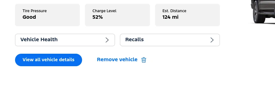

I'm not seeing it anymore. That 52% is my HVB. (Yes, I'm sure.)
That is indeed not the HVB - it is the 12v LVB. We are sure. Discussed numerous times over the last few months.

@Ford Motor Company in their mysterious ways have corrected the web code at Ford.com, it's now showing our HVB instead of the LVB mentioned in multiple threads prior to 8/4/2024 a day which will live in infamy.
https://www.f150lightningforum.com/forum/threads/lvb-on-ford-website.20760/
3,791
4,895
Well - that is a big step backwards. I've missed that in the last few days. I last checked about a week back - my LVB was sitting at 98% and the truck was at about 72.
Apologies to @mb0220 - going to take a while for us to unlearn this one and to cuss @Ford Motor Company for taking away something that was critical to know, even though they didn't have it fully labeled for many months.
And sadly - I'm sure there are rounding errors, but as I check just now one says 68% and the other says 69% for mine. I wish they could have double checked all their code and looked professional while updating that display. The rounding function we use in America has been the same since I learned it 50+ year ago. If the next digit is a 5 or higher the you raise that last displayed digit. Too bad the Web GUI developer and the app developer don't know each other.
