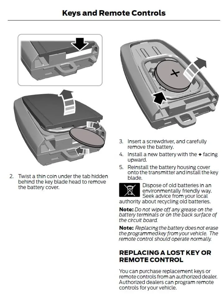

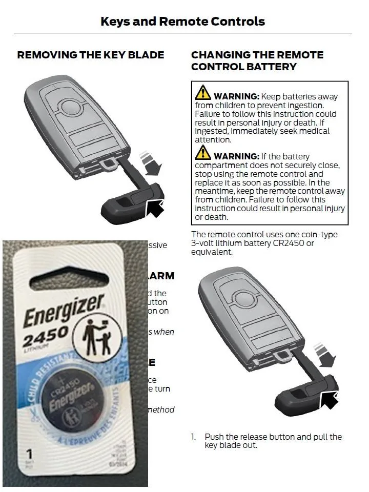

The other reason I'm posting here is that the fob battery is not the expected CR2032 that goes in many garage door remotes, in this case it's a CR2450 and below are a couple screenshots from the owners manual (my new battery also on the inset):
Ford F-150 Lightning Key Fob Battery Replacement fob1
Ford F-150 Lightning Key Fob Battery Replacement fob2
So maybe in the future another owner will recall this post and search on "CR2" and will have a handy quick reference.
