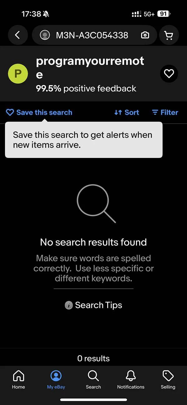

Search programyourremote on eBay and type in your FCC number. I bought one from them for my 24 Flash, It is OEM, decent price, and programmed the first time.
If we are allowed to post links I can do that.
If you have issues finding the store let me know and I can PM you.
Links are fine to be posted. I tried and got nothing. I must be half a retard. ? (because you never go full retard!) anyway if someone can link to an oem 315mhz key fob with the remote start button id appreciate it.

Damn..must not have that frequency. Maybe message him... he's got a real business down in Tampa
