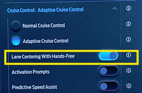

CRUISE Control types, with Lane Centering option...
not clear if LC can be set if only 'Normal' Cruise is chosen
Ford F-150 Lightning Lane Keeping (or Lane Centering) automatically engages with Cruise Control? CC modes
this Following Distance is set by my truck, since I have no 'button' for this(some have added it)
the ICON should show on the Driver Screen when Enabled, and lights to GREEN when Active
Ford F-150 Lightning Lane Keeping (or Lane Centering) automatically engages with Cruise Control? ACC icon
LCC is only while Adaptive Cruise is ON,
although it is unclear is this means while ACTIVE, or just when ENABLED
Ford F-150 Lightning Lane Keeping (or Lane Centering) automatically engages with Cruise Control? LC explained

SO glad to find this thread... looks like everyone thinks the Adaptive cruise with FORCED lane keeping is a terrible change.
I, like everyone else, am getting into the new habit of pressing both buttons on the steering wheel. Cruise on, lane keep off.
In the Driver Assistance settings on my Flash, select Adaptive Cruise, and there is a "lane centering" setting, which I have switched OFF - but lane keeping/centering/whatever enables every time I turn cruise on anyway. FIX THE BUG and allow us to disable lane keeping when using adaptive cruise - like it was before the latest software update.
Oh and added fun... if you turn on cruise (you get the crappy lane keeping) but if you then turn cruise off... the lane keeping stays on. UGGGH. Please revert this change to work correctly like it was before the update.
