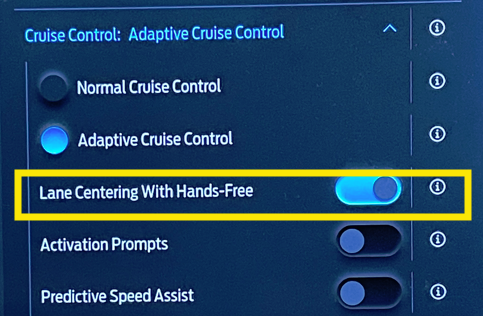

@RLXXI @EVpower It used to let you turn it off. There is still a toggle in Sync under Cruise Control. But it doesn't work anymore. I haven't tested if you change from Adaptive to Normal.
Thought so. My guess would be one would need to use regular cruise control instead of adaptive in order for it to not fight one with the wheel.

It seems to work when I disable it correctly using the toggle on mine even with Adaptive Cruise still enabled.

Interesting. Have you not received the IPMA update then? (If unsure DM me your VIN and I'll check).
And by saying it works - you mean the toggle works, i.e., LKA does not automatically come on anymore when you turn on cruise.

I updated it in FDRS a couple months back so everything should be on the latest including BC 1.4. I toggled the lane keeping off on the center screen and when I turned on CC, it didn't default to hands-on lane centering when I was driving. I'll doublecheck again the next time I go out.

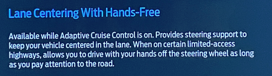

Hmm, I tested mine today. I turned off the toggle I showed in post 15. And when I turned on CC on a city street (non BC), I immediately got the popup that Lane Keeping was enabled and the instrument cluster confirmed. So despite the toggle being off, LKA still turned on with cruise for me..
I did not try a BC highway. The info screen for that toggle states:
Ford F-150 Lightning Lane Keeping (or Lane Centering) automatically engages with Cruise Control? 1754166587865-4
which kinda reads that it disables hands-free BC.

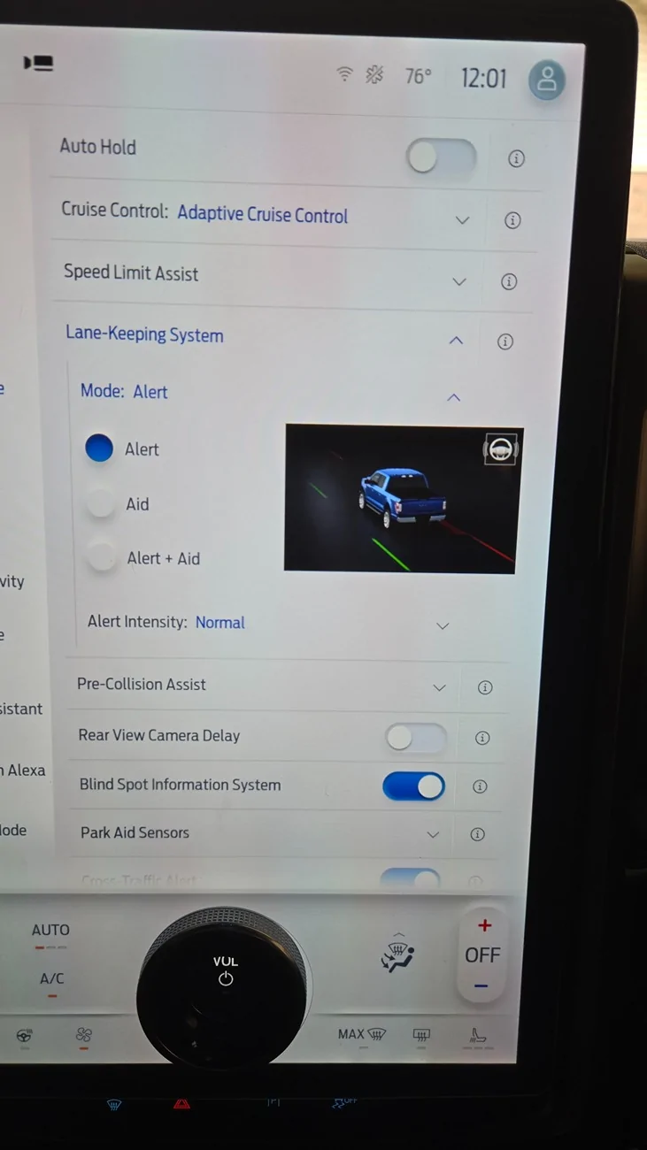

It's still there. and it works. I would never use hands free but I use cruise control all the time and I've had this setting for two years. I'm not in my truck but there is a setting under cruise control for lane alert. I have mine set to alert me by vibrating the steering wheel.

some of us are using the term 'Lane KEEPING', when we may actually be referring to the self-steering 'Lane CENTERING' function, which are obviously DIFFERENT technologies, although both have to do with 'keeping' the vehicle within the stripes:
Lane KEEPING is simply an Alert, or a 'bump' of the steering wheel, when it senses the vehicle is too close to either side road STRIPE... you can customize which type of 'help' you'd like: ALERT Only, ASSIST, etc. If you don't like any 'ping ponging' action, you can turn that 'assist' off, and have only an Alert, or maybe even Nothing.
Lane CENTERING is more of what we think about when we want 'hands free' driving: although there are two different forms of this: A) Adaptive Cruise w/LCC, or B) BlueCruise
Adaptive
is the simpler, more basic, Lane Centering, with hands-on Alert, AND Cruise 'Control' - whch includes 'following distance' control, as well as 'stop and go' automated slowing and braking, and even full STOP, when a vehicle slows in front of the truck.
From my experience, Lane Centering is automatically deactivated when Cruise is turned off, or the brake is applied, but Lane KEEPING Alert continues, unless you PHYSICALLY turn it off.
BlueCruise is the same, although with activation ONLY on pre-mapped roadways, interstates, etc., and may also include automated Lane Changing, etc. The 'hands-free' steering also allows for real 'non-alert' automated Lane Centering.
