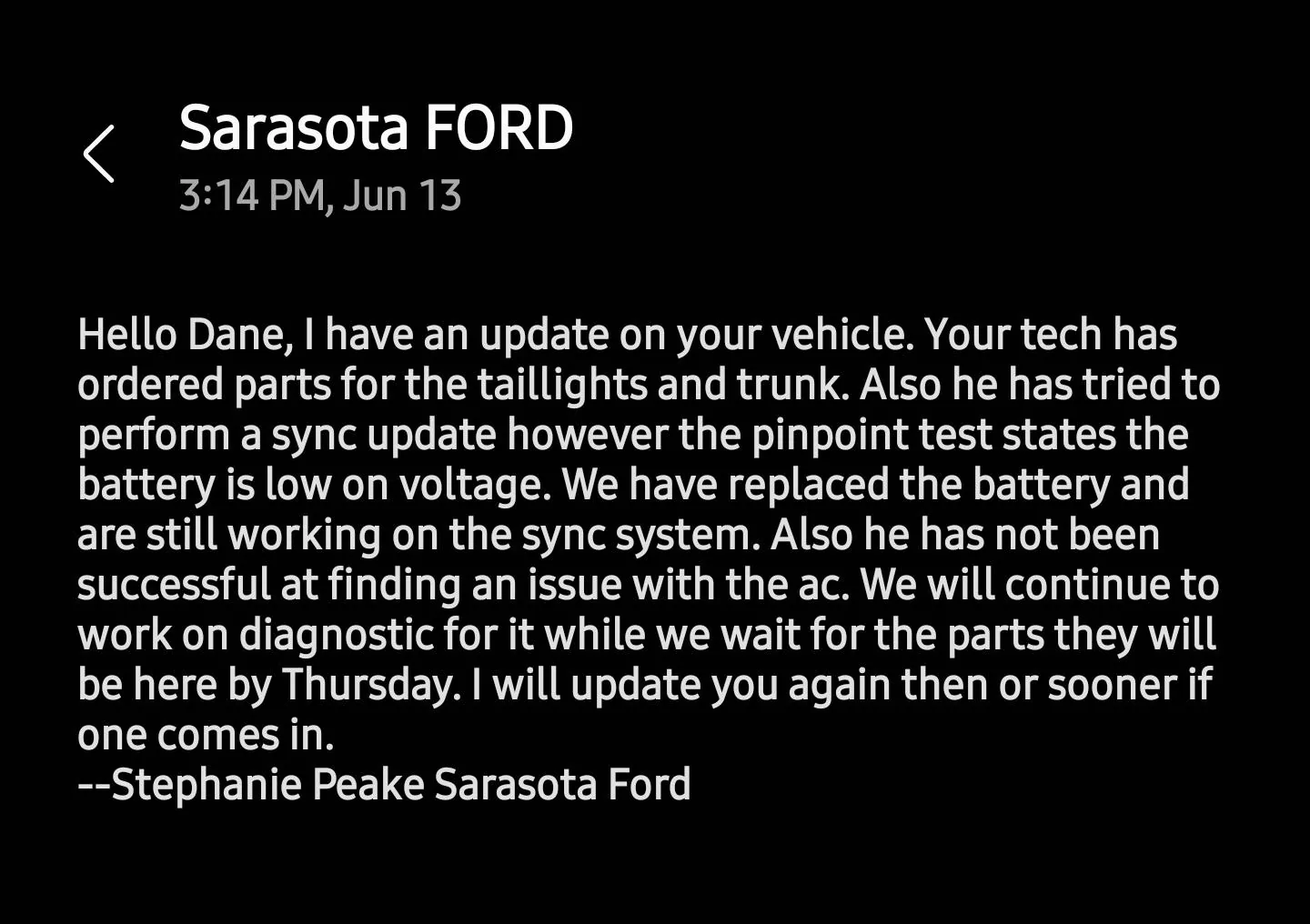

So I've had my 22' Ford Lariat Lightening for almost a month now. I love it more each day. With that being said I've got my first service drop off this Monday the 12th . I wanted to ask the group here if there are any known issues on these trucks I should be checking for to mention before leaving with them. The following is what the truck is going in for:
-Condensation across the entire rear lightbar (inside)
-Frunk lights (both) have condensation and sitting water inside them
both these items are covered under warranty of course but... a few other things that I plan to mention would be:
-extremely loud A/C run noise that can be heard from 30yds away and sounds like an airplane engine starting while standing next to the truck... is this normal? Coolant level is sitting at the minimum line so that shouldn't be an issue....
-Truck updates aren't happening. I've had 2 or 3 successful auto updates but now it's been stuck on this last one that still seems to be MANY updates from where it should be (currently I'm on Ford Power-Up 3.5.5)
What else can you fellow consumers suggest I check or have them check as known problems or future problems? Currently sitting around 4500mi on the truck
When you say "stuck", is it you just not getting updates or updates are failing? If it's the latter, have them check LVB, and if necessary replace it.
Well prior to this update I had 1 successful no issues, the next one failed while going through update multiple times until it was charging one night and it went through. Now this one just fails when trying to auto update. So it detects an update then nothing happens when it goes to get the update.
I did the BMS reset yesterday and now it says I'm uptodate which I know is wrong
