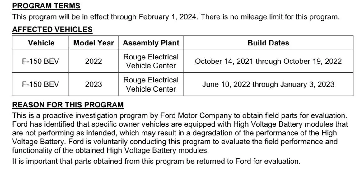

Trying to track HV battery related fails, fixes (build date, etc)
230313 Powertrain Malfunction - Reduced Power forum track list - Google Sheets
Dang google sheets are hard to paste in with a link (seemed to work just a paste ago), just goes to "Media" which does not link, so used "Code" function, which means link has to copied and pasted into a new tab to see it. @TaxmanHog
Fixed link to tracking sheet
