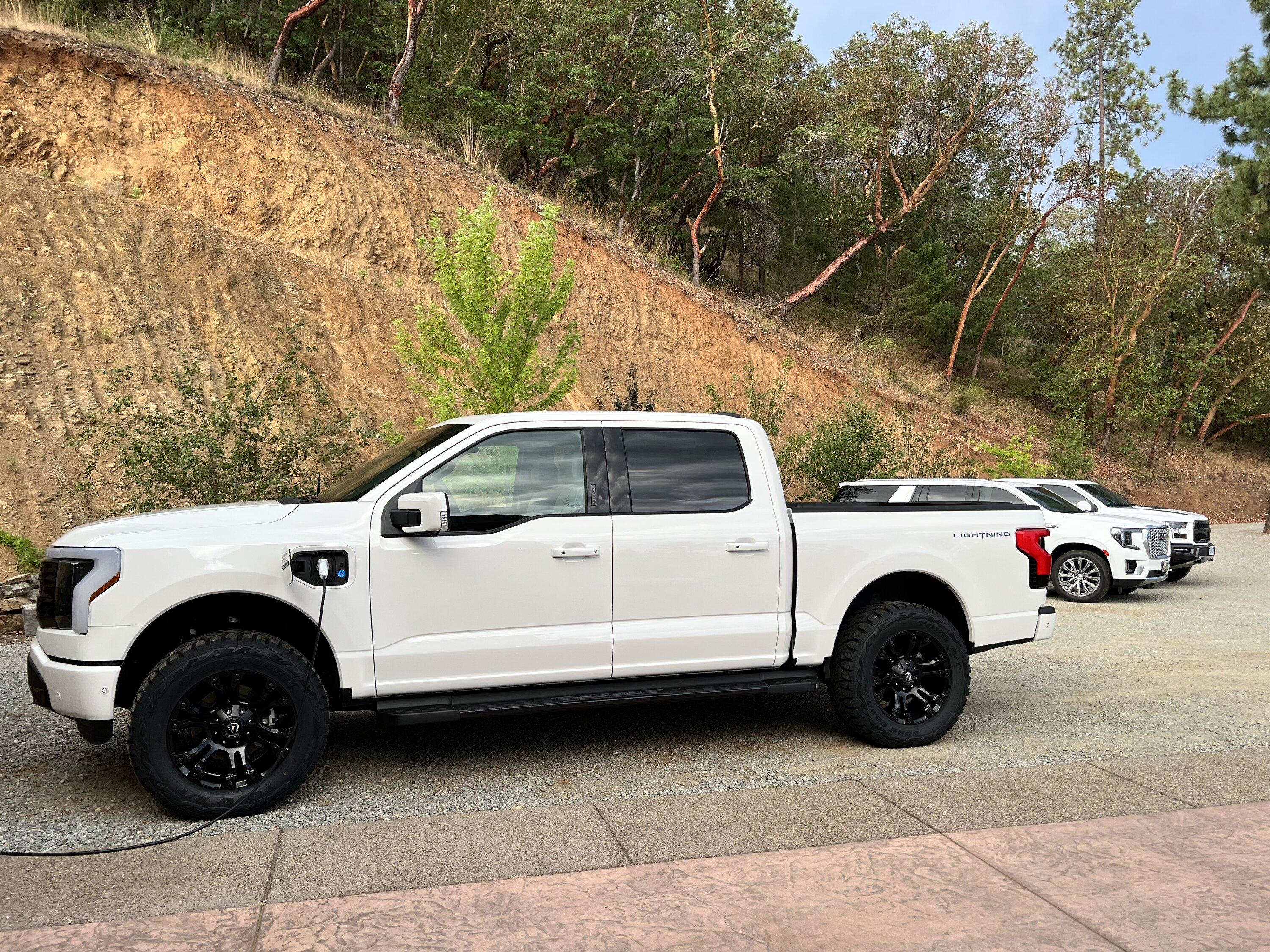

I put a 2” lift with 295 (34s) toyo RTs. I love it but it knocked off nearly 100 miles of range from my platinum toes amazing even with blue cruise
Ford F-150 Lightning Lightning Leveled on Readylift 2″ Level Kit and 34″ Nitto Ridge Grappler Tires & Black Rhino Wheels [Update: Range Drop 226 > 196 Miles] 77D8F39A-C716-4EF2-9820-EAA3B04A8F9F
joesrepsol
Joe
Jun 18, 2022
148
127
Rocklin, CA
2022 Ford Lightning Lariat
Solutions Engineer
100 miles? That seems to be the worst range change reported. Can you tell us more about this range comparison? Doing 100mph down the freeway or what?

Normal city driving for the last 500 miles and a 100% charge only reads a 224 mile range.
F150ROD
Apr 14, 2021
130
3,716
4,624
U.S. Navy Retired
There ‘s no way. The GuessOMeter is probably recalibrating or is confused….

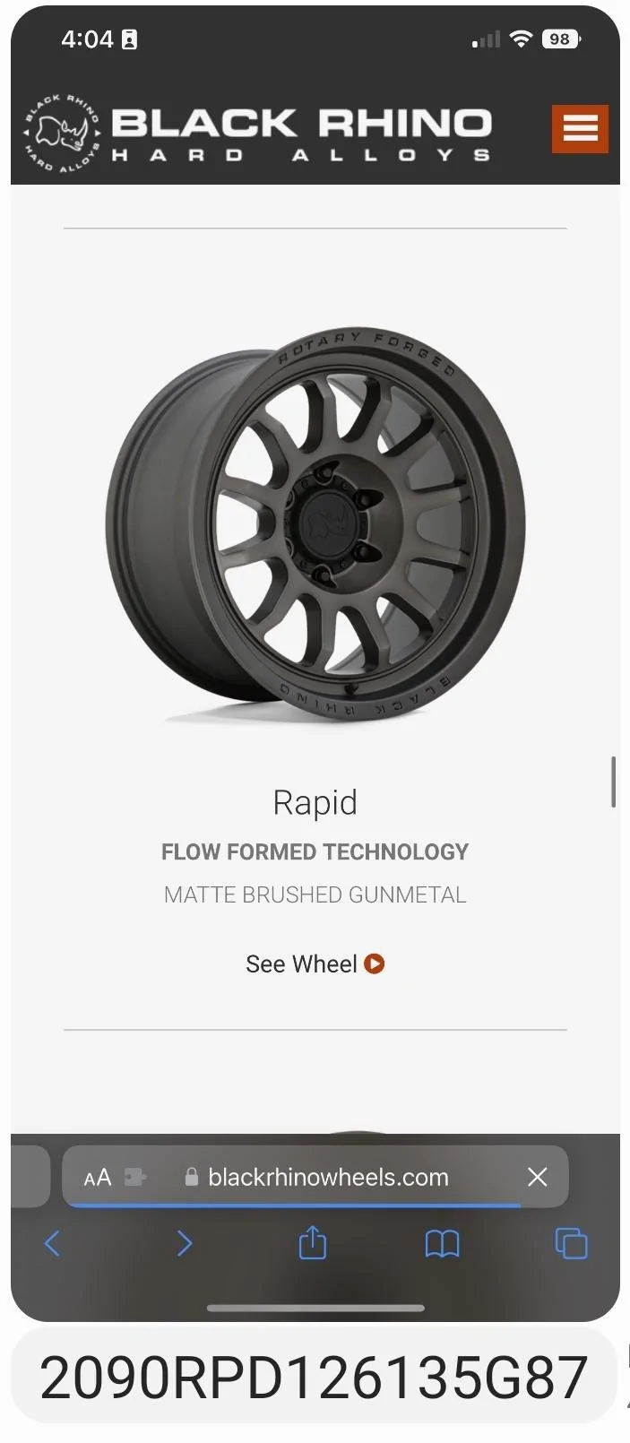

@Ford Senior Master : What color are those Black Rhino Rapids? Initially I thought they were Matte Bronze but I'm not seeing a 6x135 bolt pattern for that color so does that mean they're Matte Brushed Gunmetal?
Ford Senior Master
Ford Senior Master
Sep 19, 2021
693
622
Pell City, Alabama
Service Manager
I lbelieve they are the gun metal. I'll get the part number and check. It's been a minute...lol

Thanks for sharing all of the details. Looks awesome. Do you think there would be any rubbing issues with a 0 or 1 offset wheel vs your 12 offset? I’m looking at the exact same tire in the same size, but want just a tiny more amount of wheel poke. Looking at the Fuel Rebel which is available in either a 1 offset (5.04” backspace) or 20 offset (5.79” backspace). Total newbie here but I believe the 1 would add slightly more poke than yours, but I’m not sure if that would cause any issues. Thanks!
