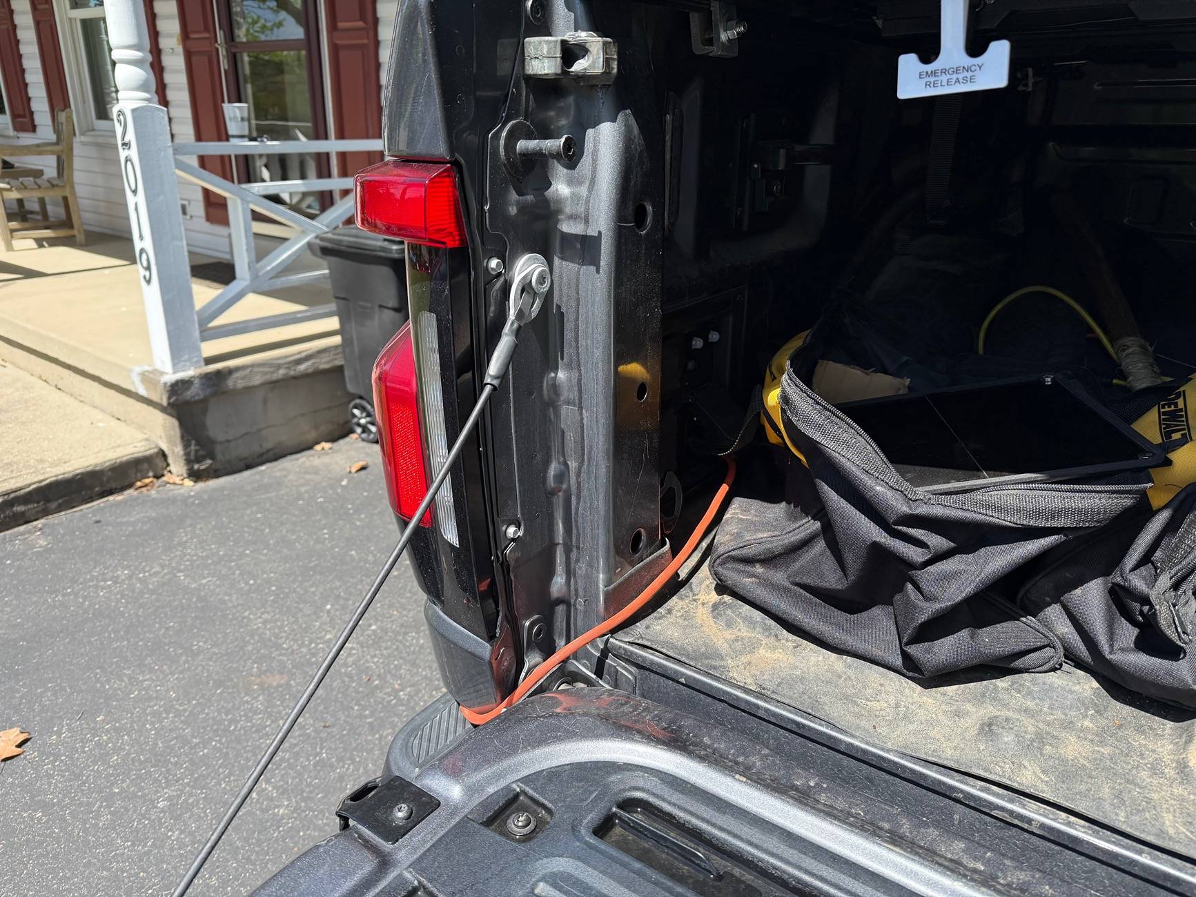

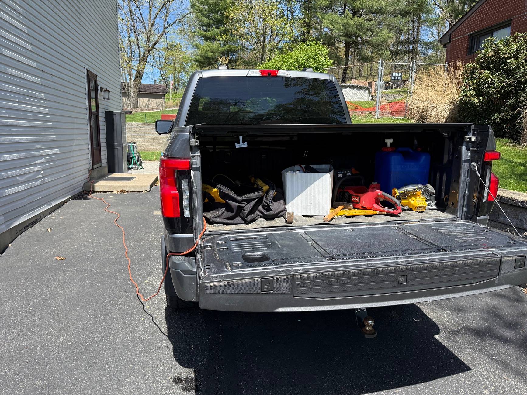

I was able to power our hot water heater, refrigerator, lighting and TV for 4 days during that storm outage in WPA. The WiFi hotspot got us streaming and able to use all devices.
Ford F-150 Lightning Lightning Powers Home During Storm - 25 kWh/day IMG_1371
Ford F-150 Lightning Lightning Powers Home During Storm - 25 kWh/day IMG_1370
