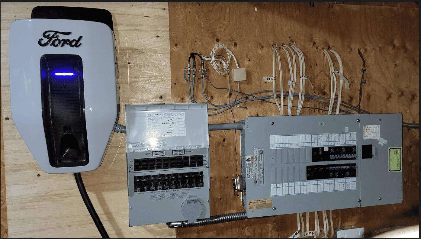

I just went simple if power goes out I plug in the truck. Low cost setup.
Ford F-150 Lightning Lightning Powers Home During Storm - 25 kWh/day 1665856187741-png-png-pn
Works no problem with the trucks GFI
FYI I turn down the Ford Pro charge station to setting #5=48 amps. wired direct to panel with 60amp breaker. When I have the $4,000 for the Sun Home Auto integration system then will set that up. This setup cost me about $800.00. I just need to plug truck in and turn it on.;)

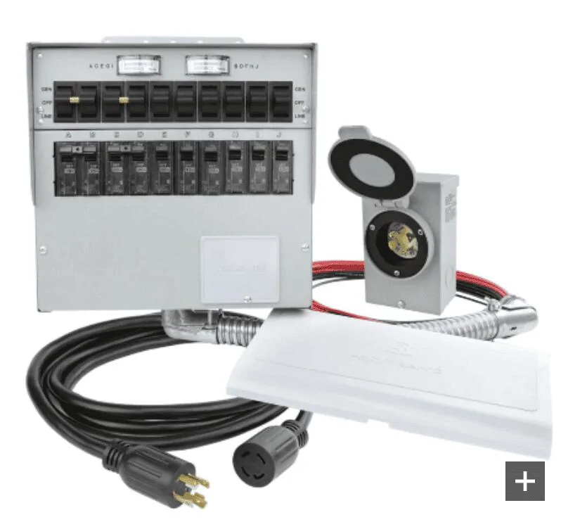

Ford F-150 Lightning Lightning Powers Home During Storm - 25 kWh/day 1669586086988-png-png
Reliance Controls 30 Amp 7500W 10-Circuit Indoor Transfer Switch Kit
Model # 310CRK|Store SKU # 1001061741 Canadian Home Depot US unit maybe different.
I took the generator connector plug out of the remote outside box, and installed it in the optional position in the transfer switch panel. Since the Lightning has no gas fumes I kept the system all in the garage. The reason it works with the truck's GFI is the ground from the truck is not connected to the transfer panel. Some people have technical issues with that.

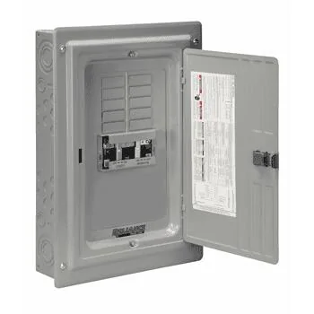

There is a thread that a Lightning owner purchased the Reliance Control panel that works with GFI generators.
Ford F-150 Lightning Lightning Powers Home During Storm - 25 kWh/day 1672585533335-png
XRC1005D Panel/Link® X Series
The New Reliance Panel/Link X Series is a double-pole manual transfer switch with an exclusive third-pole for the neutral that switches sequentially. The X Series is perfect for use with generators having GFCI protected outlets, bonded neutral generators and installations requiring a separately-derived system.
On GFI protected generators, the X Series will prevent a ground fault which will, in turn, prevent the circuit breakers on the generator from nuisance tripping.
