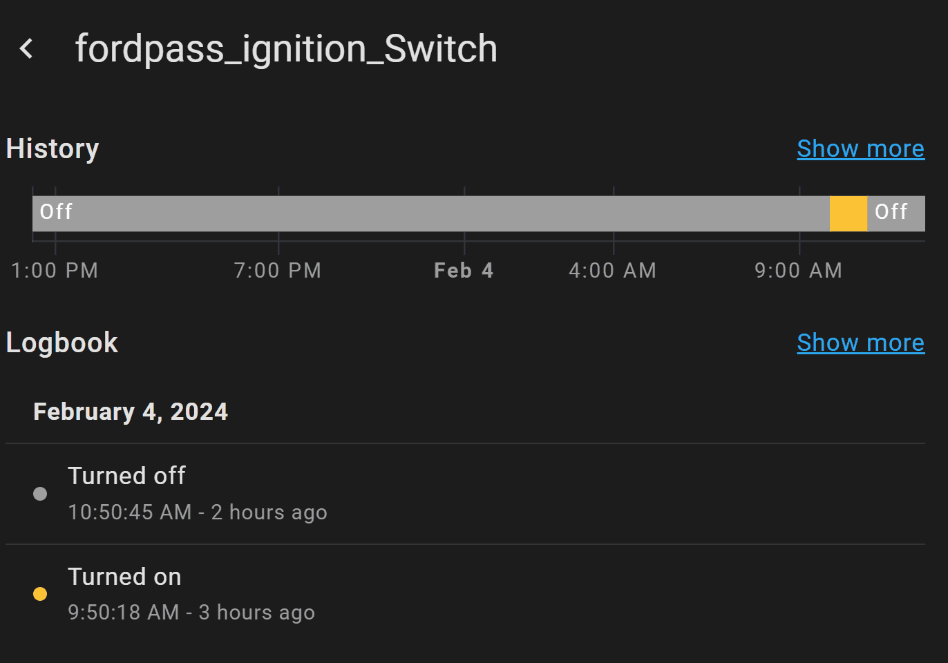

The home assistant integration for fordpass has an on/off indicator. It's as up to date as you are willing to have it refresh the data.
Ford F-150 Lightning The tell if Lightning is “on” w/Ford Pass? 1707067441090
