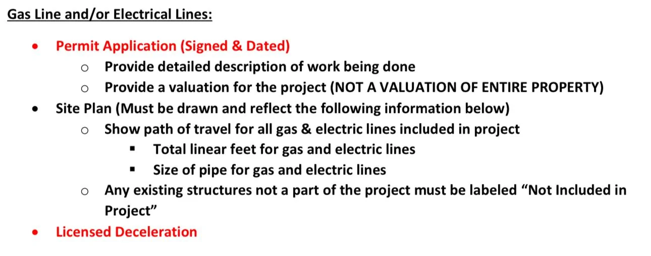

What about the site map drawing, not really my area of expertise? This is from my cities permit requirement

You can copy the tax parcel map and add the house and panel location and new panel and old panel Locations . They just want to know where you are putting things and making changes. My county accepts hand drawings. I use the same site plan over and over again.
You may be able to get a site map from a previous permit on the property and modify it
Talk with permit department they are usually willing to help you out with whats needed.
Description: Adding a critical load panel with transfer switch. Include data sheet or description sheet for the Generac model your using. List wire sizes and types. Your electrician should be able to give you this informtion (ie thhn wire size in conduit or romex wire size)
Cost: Just a reasonable estimate. They will base the permit fee on this. That's it real purpose.
If your not sure go in and talk to the department. They want you to get the permit and are willing to guide you. You can always decide after you talk to the department you don't want to do it your self and look for a contractor who will do it for you
Under License Description put home owner or the electrician license who is doing the work.
When I installed my EVSE, I had to do a map drawing. I got out the ol' trusty, dusty tape measure, did an exterior wall mapping of the home, and drew it out in Draw.io.
My city also has a portal for permits, where you submit your permit, but also look up permits for work performed. But that search isn't just for your house, but any house. I reviewed some similar permits to get a sense of what was being asked and replicated it for the permit drawing. Easy peasy!
