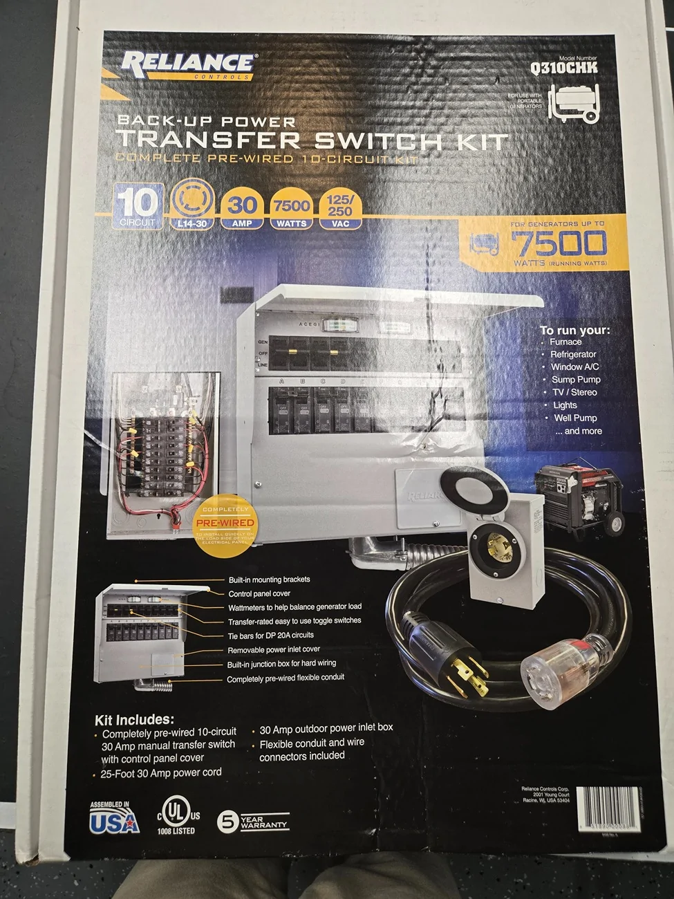

I am planning to install a manual transfer switch to power my home's emergency circuits (refrigerator, plugs and lights) from the Lightning during a power outage.
A friend of mine gave me this unit he had and never used. Does anyone have experience with the Reliance Controls model Q310CHK if it will work for this application or have any other suggestions, tips or tricks?

"completely pre-wired"?
Looks like an electricians nightmare.

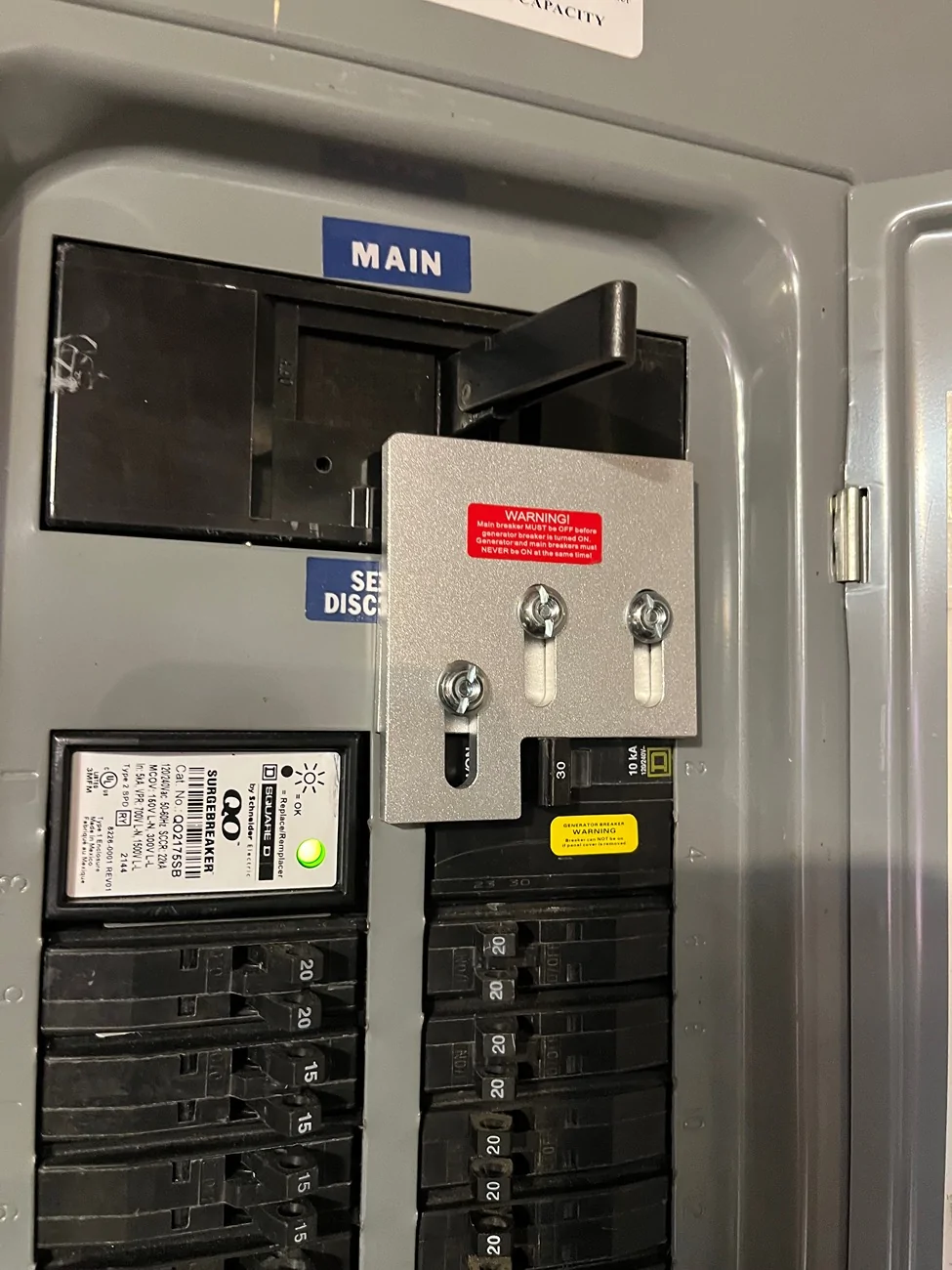

I wouldn’t bother with that panel. I just feed the truck directly to my main panel via a 30 amp breaker. And have a main cutout switch for main breaker. You can pre-determine which breakers to open so you don’t exceed 30 amps. (See picture)
This way you can get power to anywhere in house (just not at the same time).
What did you do to address the bonded neutral issue tripping the GFCI in your Lightning?
Here is some additional info regarding your new equipment that might be helpful:
https://www.nooutage.com/310.htm

How did I address the bonded neutral issue. Don’t tell anyone, but I just pulled the unshielded wire out of the receptacle that the cable from the truck plugs into. Some day long after I’m gone (due to electrocution) someone will wonder why the unshielded wire is not connected.

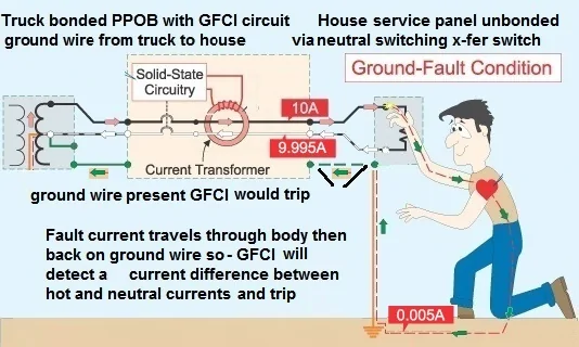

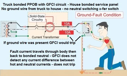

I believe that is a transfer switch designed for unbonded/floating neutral generators.
Because of that, the GFCI of the Pro Power On Board (PPOB) from the Lightning would trip when connected to your bonded service panel because there would be a ground loop created and a return path for current on the ground and anything connected to it, such as metal parts of your service panel. The neutral would be bonded in two places - it should only be bonded in one place, in this case the Lightning.
So what you really need is a neutral switching transfer switch like the GENERAC 6853 for example to comply with the NEC and what your local electrical contractor and inspector will require. Such a transfer switch can be had for under $400 with the generator inlet box and a 10 foot 30A generator cord
This video explains how to use a bonded generator (which the Lightning inverter output is) to power you house:
Note: Newer NEC code does not require the connection to a grounding electrode (ground rod) to be near the generator as mentioned in the video, so as I understand it, being grounded by the house grounding system and the house grounding electrode system via the ground wire is sufficient to comply with the code.
"...A 'grounding system' and a 'grounding electrode system' shall be 'connected to the ground terminal' on the portable generator. See NEC Article 250.34(A)(4) and (5) for code compliance."
In the NEC, a "grounding electrode system" is the composite of "all installed grounding electrodes" at a building or structure that are bonded together "to provide a low-impedance path to the earth."
If you do not connect the ground wire from the Lightning to the house, you will not be in compliance with the NEC code and your install should not pass inspection.
Here's one reason why disconnecting the ground wire is a dangerous:
The ground wire provides a low-resistance path for fault currents (current flowing where it shouldn't) to return to the generator source, which allows safety devices like circuit breakers or fuses to trip and disconnect the power. Without a ground, fault currents might flow through unintended paths, like a person's body, potentially causing severe shock or electrocution.
A ground fault in a circuit in your house would not be detected by the GFCI in the Lightning without the ground wire back to the Lightning, so the Lightning GFCI would not trip in that case to deenergize the circuit.
In the event of a ground fault, circuit current is divided between the ground and the neutral in parallel, but this will not open the panel breaker shutting off the circuit. Because the current is divided between the neutral and the ground, if the ground is connected to the Lightning ground, it would open the Lightning GFCI. But without the ground wire back to the Lightning, the fault will not be detected and the GFCI will not disconnect the circuit.
Ford F-150 Lightning Manual Transfer Switch ground fault - truck GFCI wont tri
Note: if the ground wire is connected it is assume a neutral switching transfer switch would be used and the neutral would no longer be bonded at the service panel of the house:
Ford F-150 Lightning Manual Transfer Switch With Ground wire and N-xfer switch GFCI will tri
