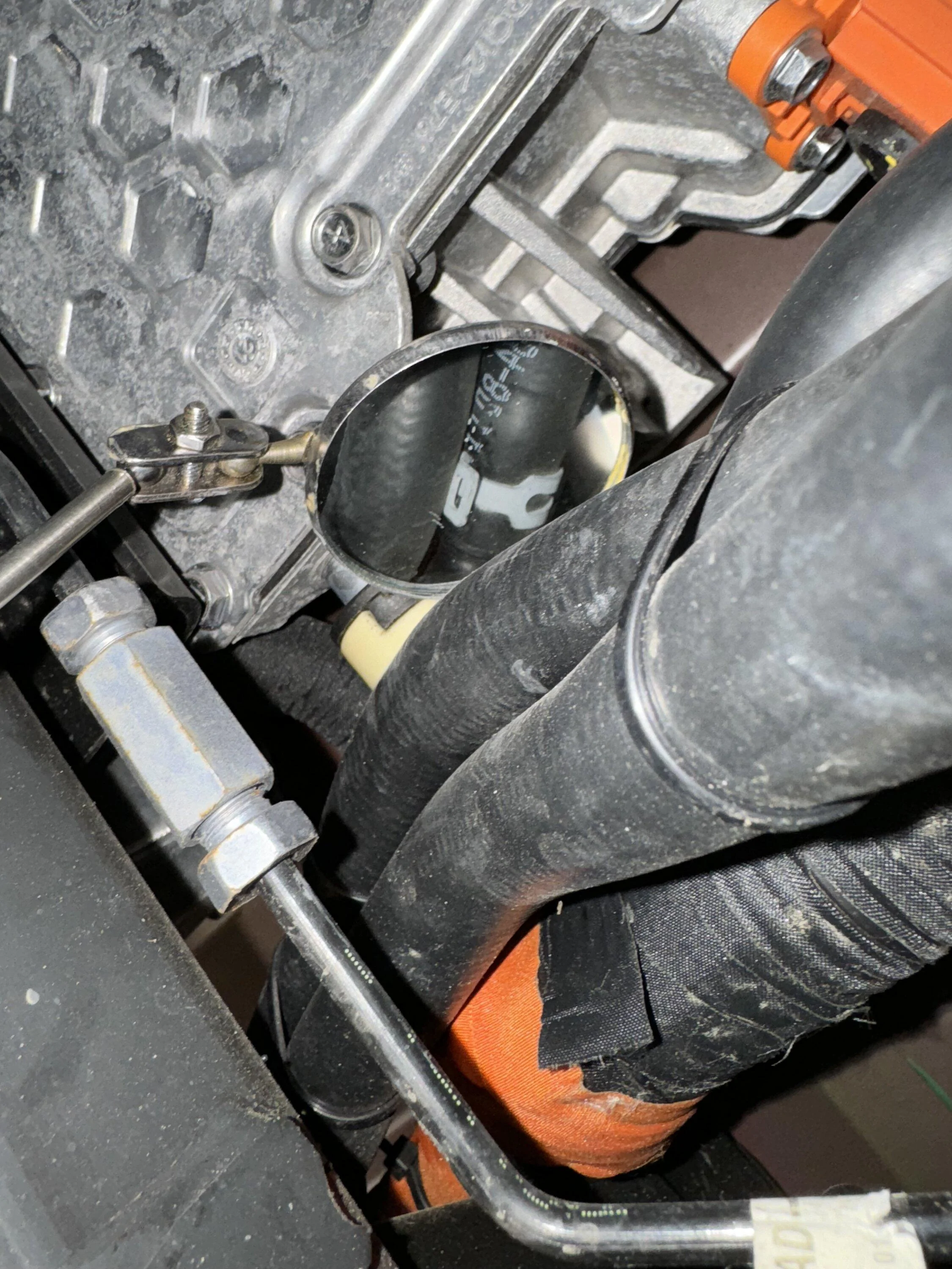

I confirm this defect also exists on my 2022 Lightning. I just crawled under my truck and took the attached photograph to document the defect.
The best way to access the location is from behind the left rear wheel. Use the bright tube coupling for a landmark. You can not see the clamp from below, but you can reach around the 2 black hoses and feel it. The "ears" on the clamp do indeed press against at least one of the hoses. There is not much slack in the hoses, but I got just enough slack to insert a piece of flat rubber between the clamp and hoses until it can be repaired by a dealer.

I think this is the same spot and my lines are not configured like that and the clamp ears are down. Mid 2023 build. Edit: Extended Lariat.
Do you have a Standard Range battery? I failed to mention that my photos are for an Extended Range battery.

My clamp is clocked in a position where it will not damaged another hose. Seems like a mixed bag of whose clamp is installed correctly.
