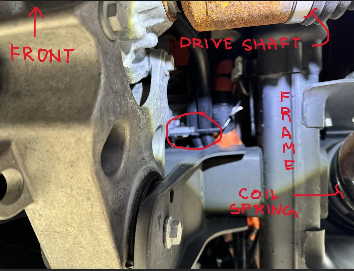

Attached is a photograph with a wider view to help locate the defect area. It is on the opposite side of the frame rail from the coil spring, on the top side of the hoses in the center of the photograph.

Failure of this specific hose, outside of the warranty window, should absolutely be covered by @Ford Motor Company since this is an installation error.
I agree. I just hope I don’t have to have that argument at a Ford dealer 600 miles away from home on a road trip.

If it does fail in year 4, is the part and labor covered under 8 year power train warranty? or this is not covered since electricity is not flowing through the hose?
If you plan on keeping the Lightning past 3 years, get the extended warranty. 100% worth it with all of the electronics and gizmos in the truck.
Yeah but you can't see the hose clamp. Is it pointed down into the other hose? I think it's too early to label this a "defect area."
I think you did not read my previous post.

We just need to butterfly clamp the two hoses together to maintain positive separation. Honestly, having worked in aerospace as long as I have, seeing how car systems are routed makes me angry.

This might be specific to the trim or options as my 2023 no option PRO doesn't appear to have these hoses.
Do you have only 2.4KW of PPOB?

It's a base PRO with zero options. No max tow, no tow tech, no nothing. zero, zilch, nada.
Makes sense, the 7.2KW inverter is back there where the the additional plumbing is located.
My concern is not only with routing, but also attachment. Did Ford design and test the "tie wraps" and tape (on the orange conductor) to last for 100,000 miles?
