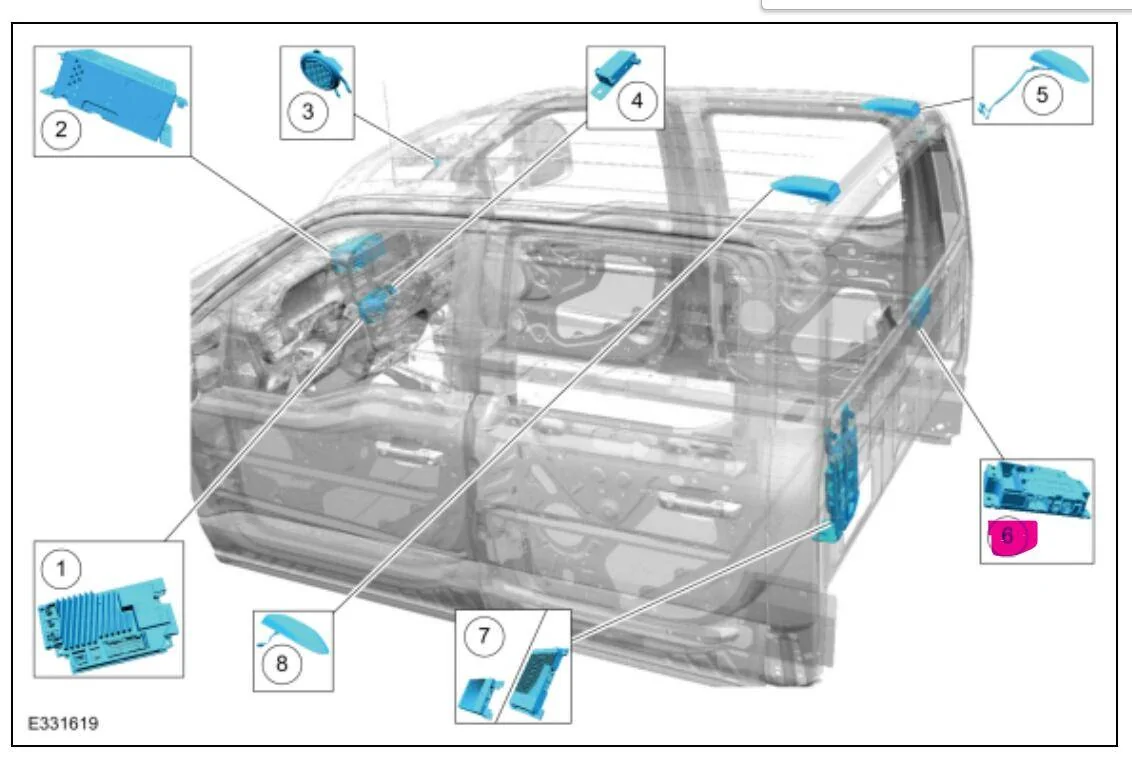

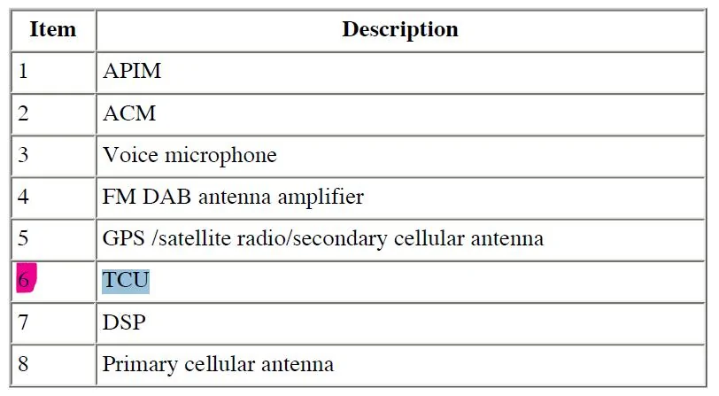

correct. I pull back the trim piece behind the rear passenger seat and pull the plug directly. It is significantly faster than pulling fuse 32 (which doesn’t really work by the way) or pulling off the 12v in the frunk. It also requires no tool (now that I leave the holding clip off). I am really surprised others don’t report this as much. Most Ford pass issues, and HIS issues all point to the truck modem yet everyone blames the app or other equipment. I have proved all those by checking the truck connectivity anytime something else doesn’t seem to be working right.

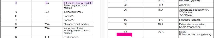

It is possible that either fuse might solve the problem, no doubting those who had success with fuse 32, let's assume these two devices are in communication with each other, causing the chain of com's to stop, try pulling fuse 8 the next to see if the same positive result is achieved.
32 is listed as Radio / Enhanced central gateway
8 is listed as the power to the Telematics CM & Power tailgate CM

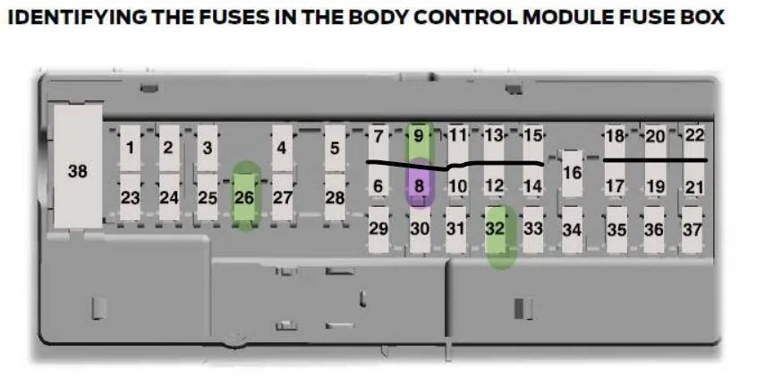

I don't seem to have a fuse 8. The Fuse box goes 4,5,7,9,11, etc.

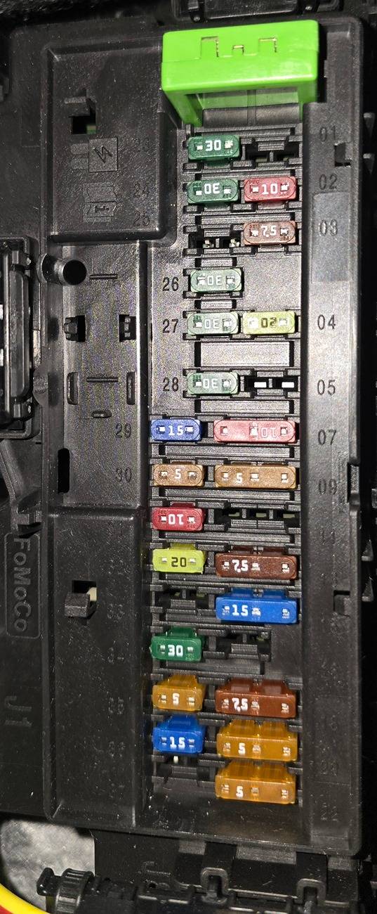

What year is your truck??
The graphics I posted are from the 2022 Owners Manual
It is a 2023 MY, although it has an october 2022 build date.
Upon looking at the actual fuses it seems that fuse 8 and 9 are the same physically.
EDIT: never mind, fuses at locations 7/6, 9/8, 11/10, 13/12, 15/14, 18/17, 20/19, 22/21 cover multiple circuits, FORD ya need a better & clearer way to document this !
I looked at the MY23 owners manual, same layout.
Note the graphics makes it look like one fuse, IIRC they are seperated I've modified the image:
Ford F-150 Lightning Connectivity Dead - 2024 F-150 Lightning Lariat 1728427224264-ev

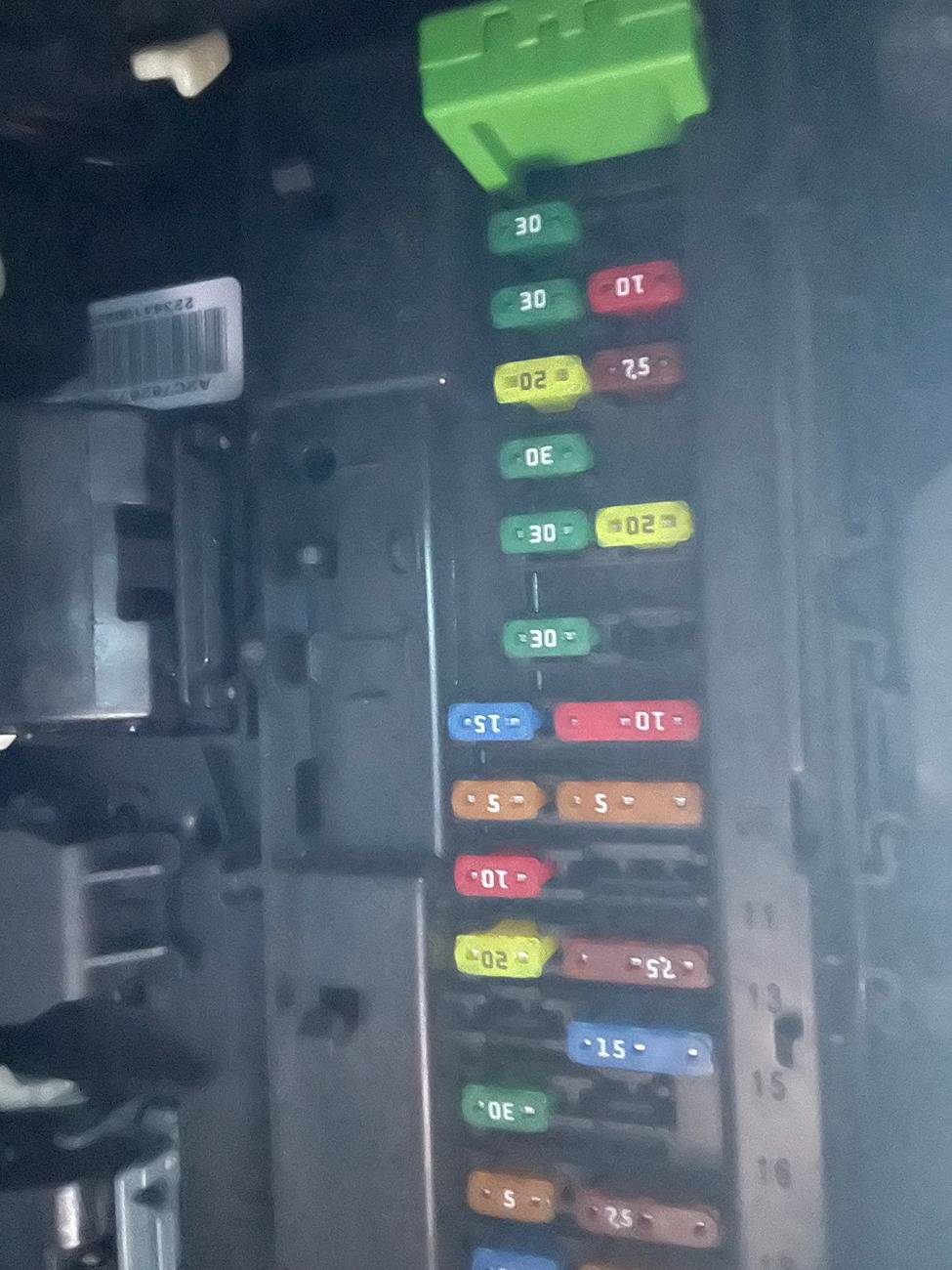

No it really is one large fuse. There is nothing that actually says 8. It really should say 8/9.
Ford F-150 Lightning Connectivity Dead - 2024 F-150 Lightning Lariat IMG_2045
206
15,142
16,782
Well golllly [/gomer]
If I'd actually gone out to look like I just did on my coffee run, snapped a photo!!!
I stand corrected.
Ford F-150 Lightning Connectivity Dead - 2024 F-150 Lightning Lariat 20241008_185519
Interesting...when I'm back home I'll go out and check mine as well and provide another pic.

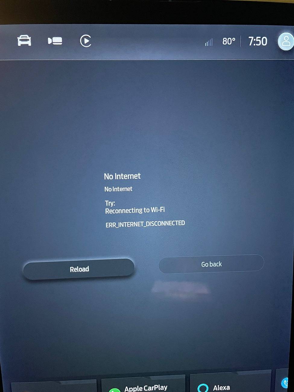

So after pulling fuse 32 and going on one trip of about 2 miles, the modem was locked up again when re-starting the truck. Interestingly enough during that time I received the karaoke 10.1.0 OTA.
I believe this is why I say that fuse 32 is not a reliable solution though. I believe there is something else going on that the fuse just doesn't take care of. I have gone ahead and pulled all 3 connectors off the modem for about a minute. The next time I will pull both fuse 8/9 and 32 at the same time and see what happens. If that doesn't fix it, then I will pull the whole battery terminal, as I should be up to date on software after the 10.1.1 update.
Here is a pic confirming the problem, even though I already knew what was going to happen. This is the charging location app. For reference this is at home parked in wifi zone. If the modem was working it would show the wifi icon with full signal and the up/down arrow icon.
Ford F-150 Lightning Connectivity Dead - 2024 F-150 Lightning Lariat IMG_2046
