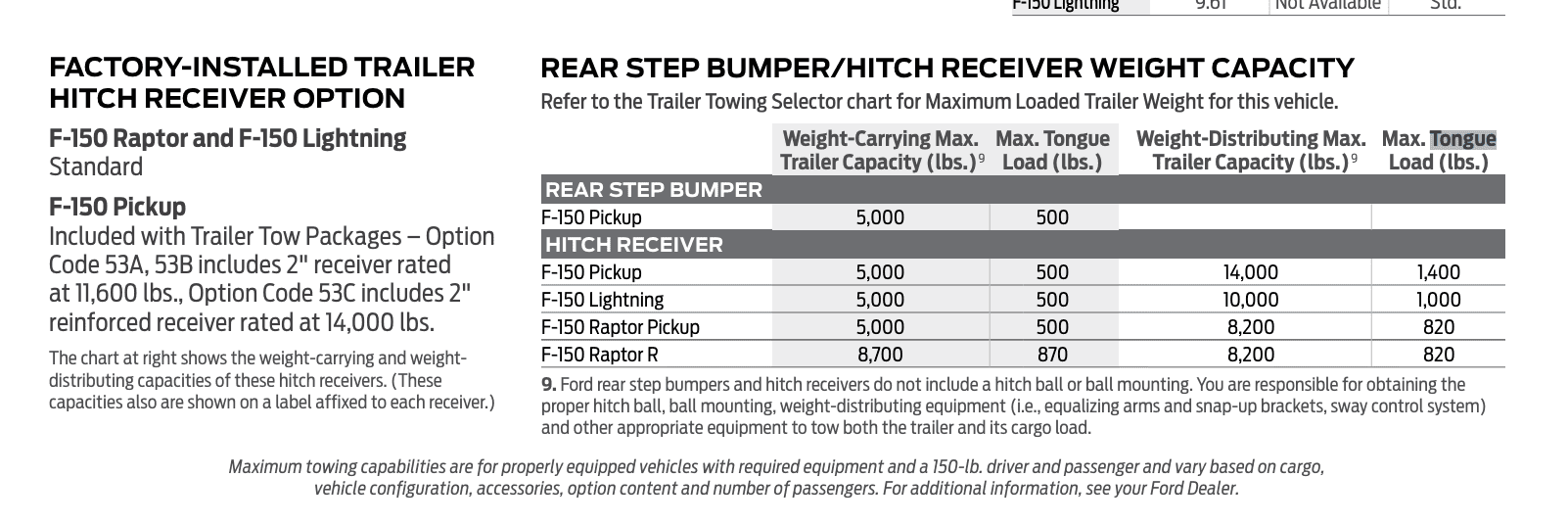

Without the weight distributing hitch, you're limited to 5,000 pounds towing and 500 pounds tongue weight.
See the table in my first comment above.

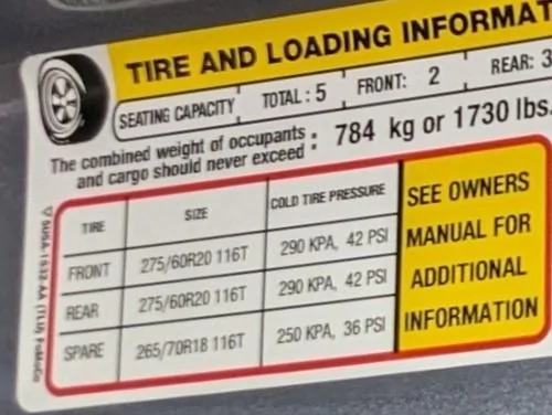

There's some misinformation here.
Yes, each vehicle has a payload limit. That's from the factory. Subtract from that anything you added to the truck (tonneau cover, liner, mats) plus people.
HOWEVER, the HITCH has it's own limits. With a WDH, it can take a max of 1,000 pounds. Without a WDH, it can take a max of 500 pounds. You cannot tow that boat safely. Sticker from my Lightning below.

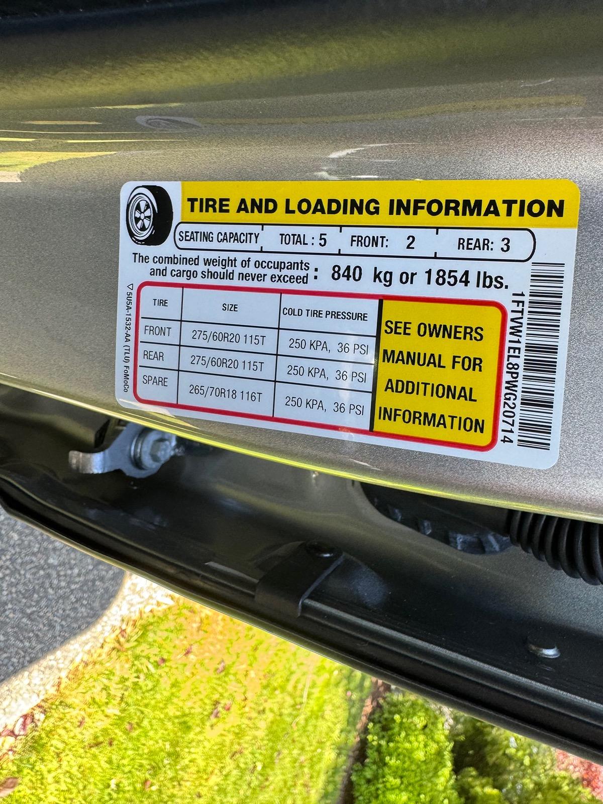

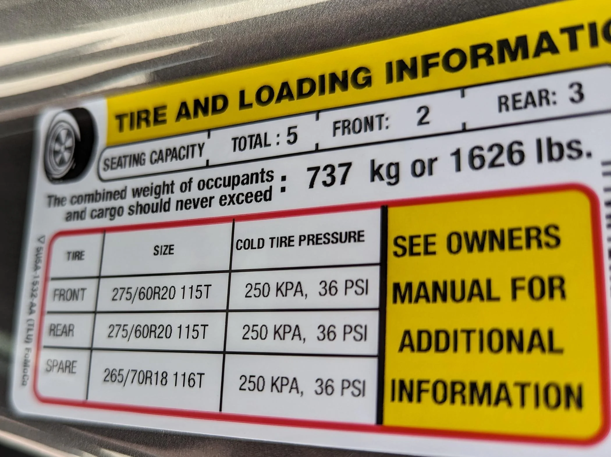

I have a lariat er. The max payload of 1730. My tongue wieght is around 600 lbs. With no equalizer it only drops the rear of the truck an inch. With people and gear I think I have around 400 lbs left. If you have max tow that takes away from your payload as it adds wieght to the truck. Tow rating is different than payload.
