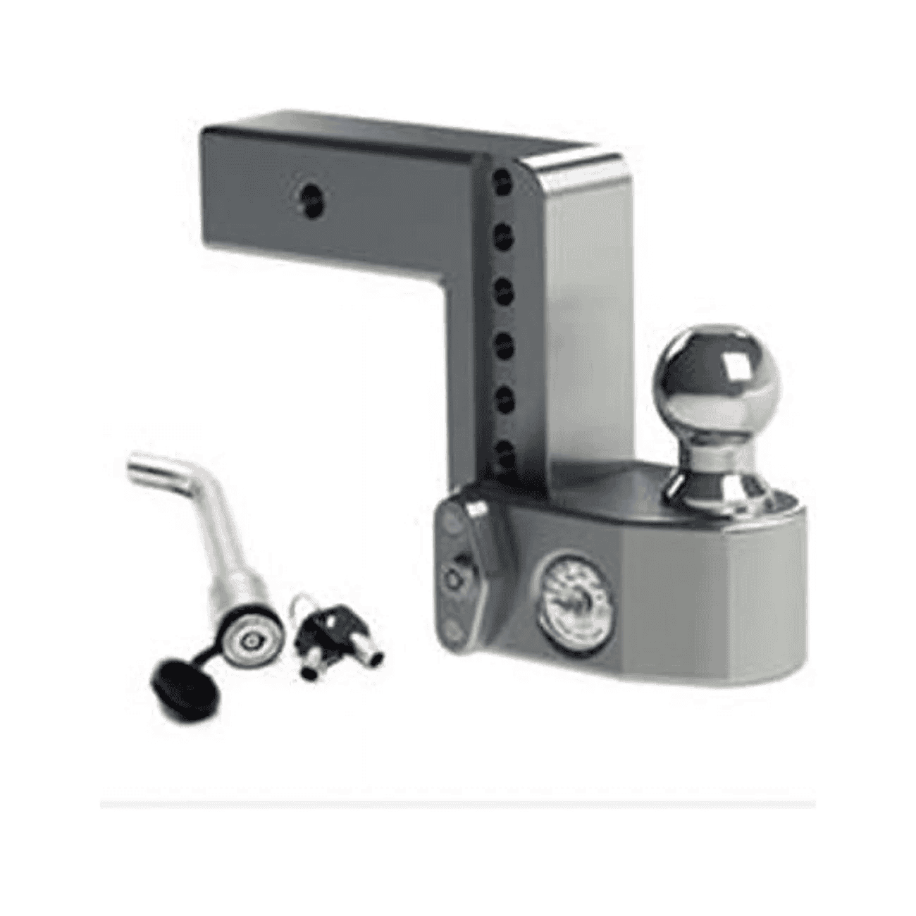

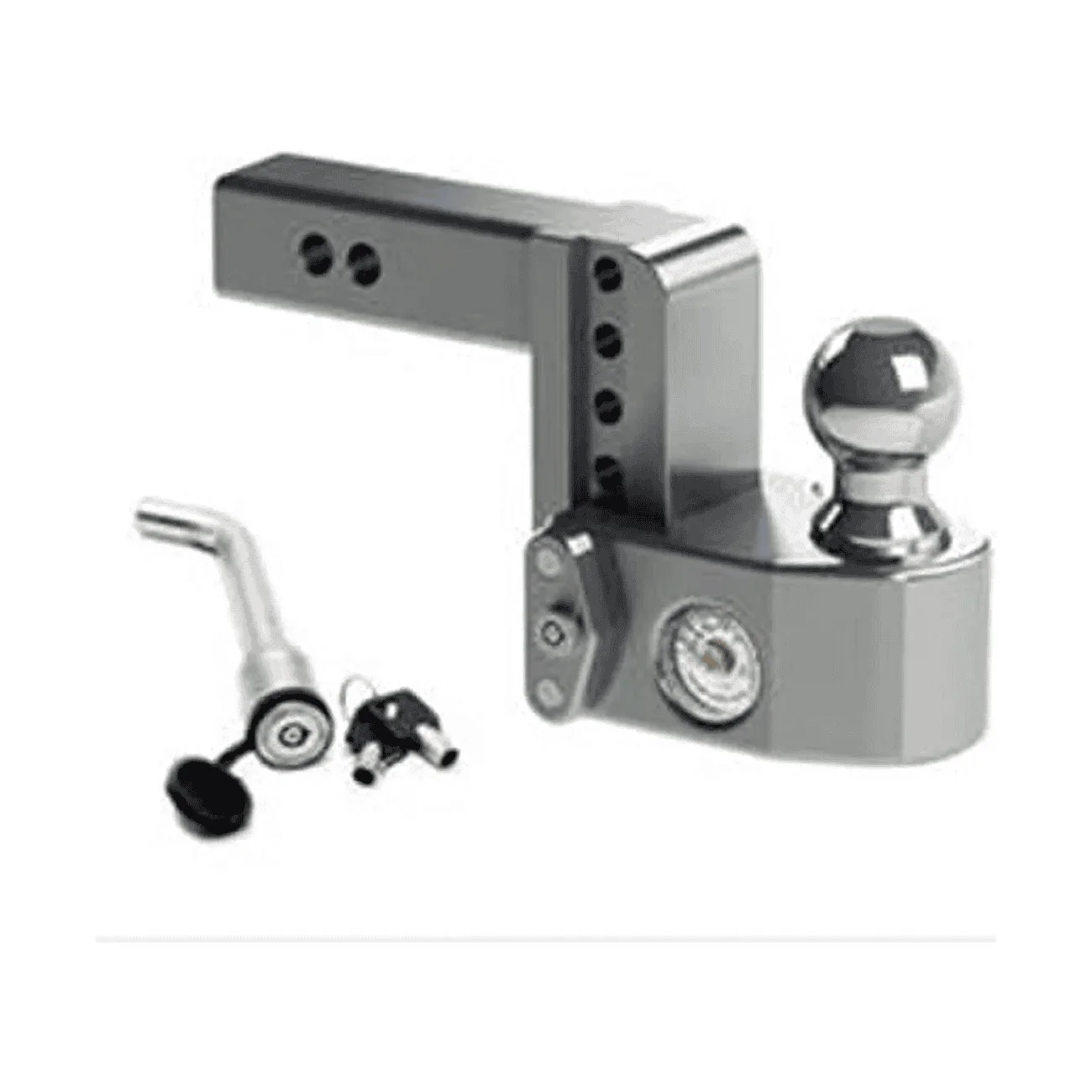

Late to the thread but wanted to inform folks on here.
I have a bunch of Weigh Safe products and went with their WDH. I had a decent discrepancy on one of my CAT weigh ins and decided to reach out to them. After going back and forth with the numbers they acknowledged my calculations were correct and that their scales can be off by as much as 120lbs.
It’s a relatively small number, but some folks may be dealing with tight tolerances. Some probably don’t care but I’d venture to say if you’re going to pay the premium for weigh safe, you probably want to be as close as possible.
Bed scales, weigh safe, are good in a pinch. But I still prefer to go weigh in if I’m going far with a big load.
