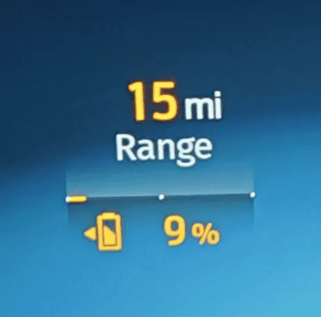

My last road trip had me down to 9%, charging went off without a hitch.
