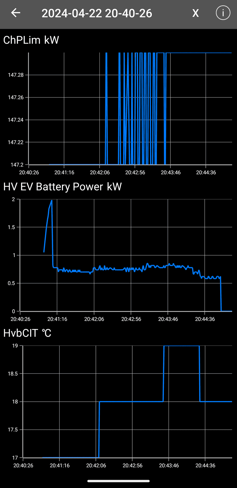

Last night I went out to check my Lightning Lariat ER. I've measured substantial preconditioning on our Mustang Mach-E in the past.
When starting up, I noted that the Lightning's Charge Power Limit was at 147 kW, which indicated it didn't need to be preconditioned. I went ahead and ran the test anyway.
The exterior temperature was 15 ÂşC, the battery temperature was 18 ÂşC, as was the inlet coolant temperature.
When I started the truck, punched in a fast charger destination within range and which has triggered preconditioning of the Mustang's battery, I did hear the truck start up a pump.
And the truck started pulling some power from the battery. But it was only 0.75 kW, which is enough to run a pump or fan, but not enough to account for a heater or heat pump.
I left it on for a few minutes, but there was no change. In the Mustang, the heater comes on almost immediately after I tell the car to navigate to the charger.
I went again this morning after a cold soak brought the battery down to 4 ÂşC and the charge power limit was down to 98 kW. So a loss of about 50 kW charge power limit.
No preconditioning. That's disappointing. I do not have any OTAs applied to the vehicle yet. I might try to convince it to update everything in the next coupe of weeks with FDRS, but we'll see.
