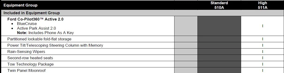

Truck 3: No. I would go with ER all day long over SR if the price is the same and mileage not terribly different. Also truck 3 (the 510A SR) does not come with a lot of features that the ER (511A) has:
Ford F-150 Lightning Need advice on 3 different Lariats for purchase. 1739824851442-4r
They could have added in Co-Pilot, Tow Tech, and storage as options, but not the others. Order Guide.
