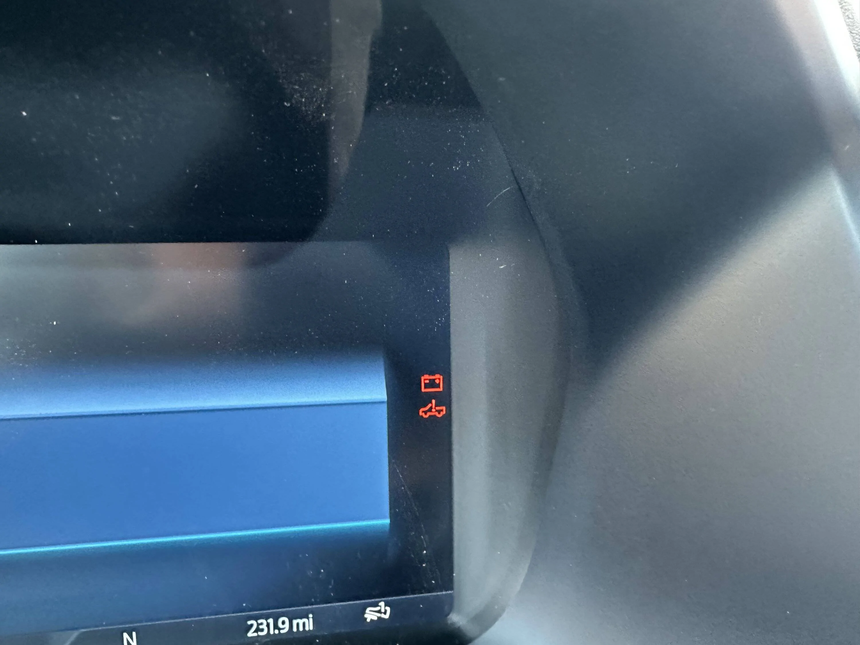

I apologize if there is a thread somewhere else that will help but here is issue…and note this is 3rd party info as I was unable to be at delivery but my wife was there.
Brand new Flash that I believe was manufactured in October 24 based on the sticker and was delivered to dealer lot on October 28th. Finally closed the deal and they agreed to deliver the car by driving it to our house approximately 180 miles from the dealer. I have advised the dealer that we will not take official delivery until we inspect the truck upon delivery to our house and the agreed. I have an email from them saying as much.
Now the problem…all looked good with the truck so my wife went to test drive it. She got in the truck with foot on break and pressed the start and the truck has power but it will not shift out of Park. The driver who delivered the truck could also not get it started. Thpic below was the only idiot lights on dash.
They disconnected the battery and re-connected still no go. The called their service who called then called a Ford mobile tech who came and replaced the 12v battery and still no go. Tech told driver that he thinks it is the HVB,. My wife had to leave so I’m hearing this info from my son. Getting ready to call the GM of dealer but was wondering if there is something simple and stupid that we can try before I tell him to give me a different truck.
