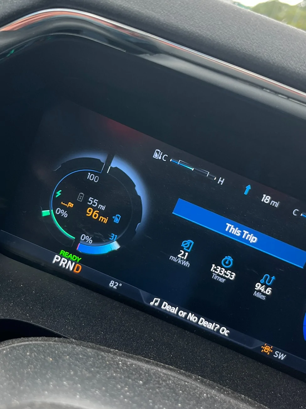

Yesterday on a longer drive for the first time there was a new graphic where the miles remaining usually is. Pic attached. The 96mi in orange never changed during the drive while the 55mi above it went down like the remaining miles usually does.

It's a nav destination.
Why it's charging slow is another problem.
Try resetting your location for charging.

Thank you! New Nav destination graphic: 96mi wasn't my complete trip. That was 112mi... Was that part of an update? I checked and my last update wasn't recently...

To me, I'm interpreting the 96 miles as your nav or phone was mapped to some place 96 miles away. The truck is going "hey, you're not going to make it with 55 miles of range. what do you want to do boss?"
It's giving you the notice to think about charging.
I would have thought the nav or AndroidAuto/CarPlay would have mapped you to the closest charger.
