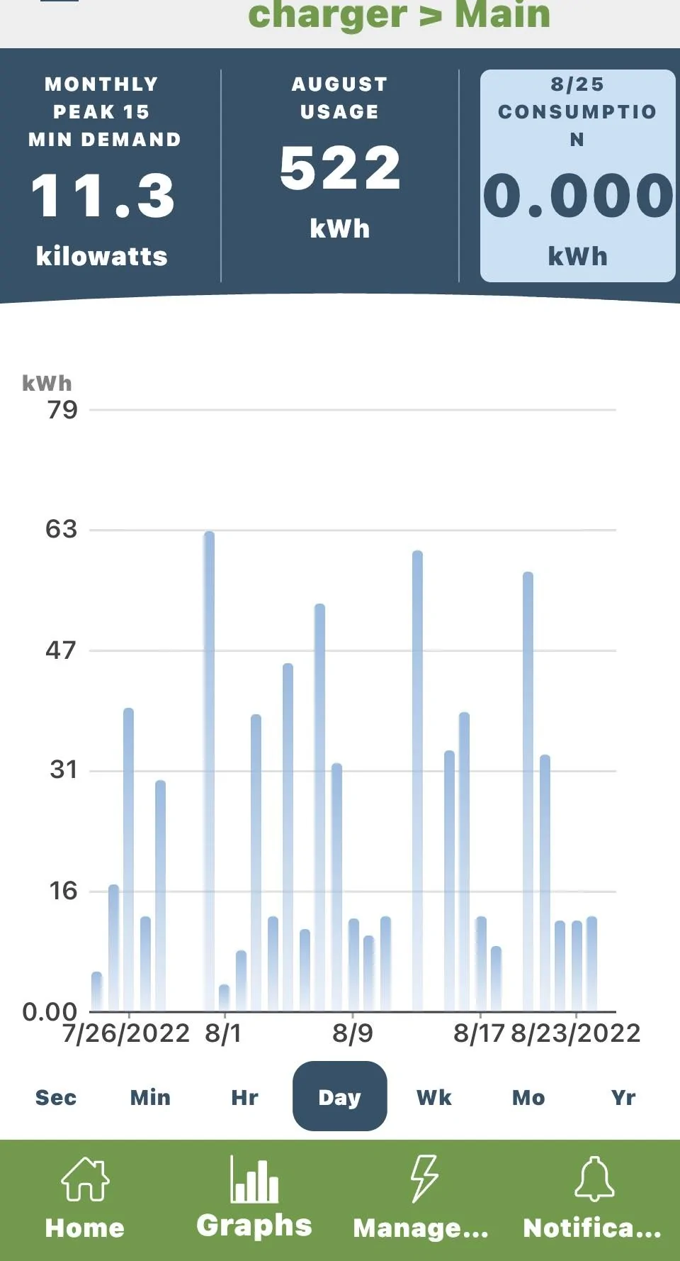

My Emporia (hardwired) gives a consistent 11kW output after a couple of minutes from start and then tapers down after reaching 90%.
It's never had an issue with 2 different EVs it charges - even in 110+ degree temps.
Ford F-150 Lightning Slow charging on AC Screenshot 2022-08-25 at 6.52.43 AM (1)

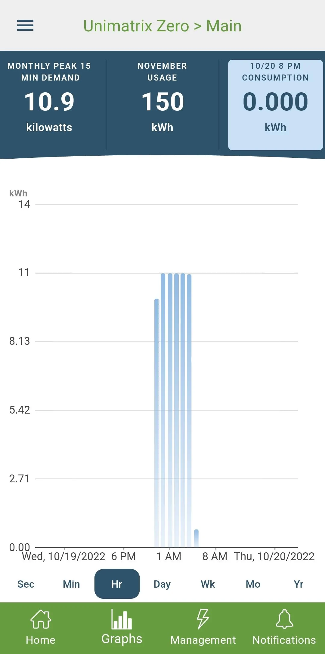

I don't plug in every day. Here are the 3 previous charges before last night. No problems.
Looks like it's working correctly now ?
I only charge once a week and charge to 100%.

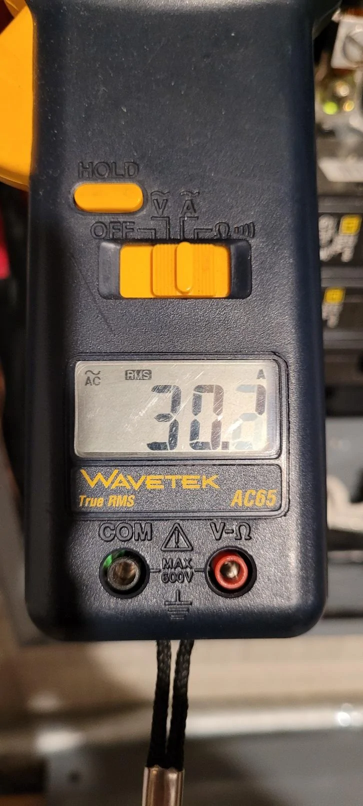

Well, I'll admit it. I was wrong. I was positive it was the truck. I guess I gave Emporia the benefit of the doubt instead of Ford. The mobile charger is pulling 30 amps. I've contacted Emporia on a solution and will report back when I have a resolution.
