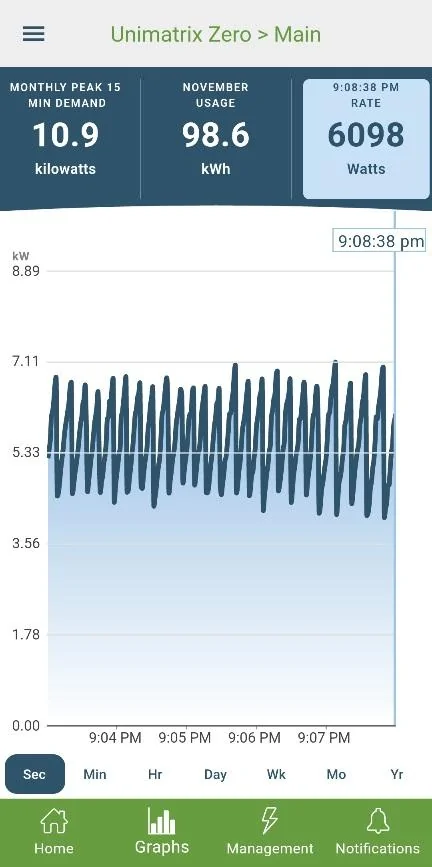

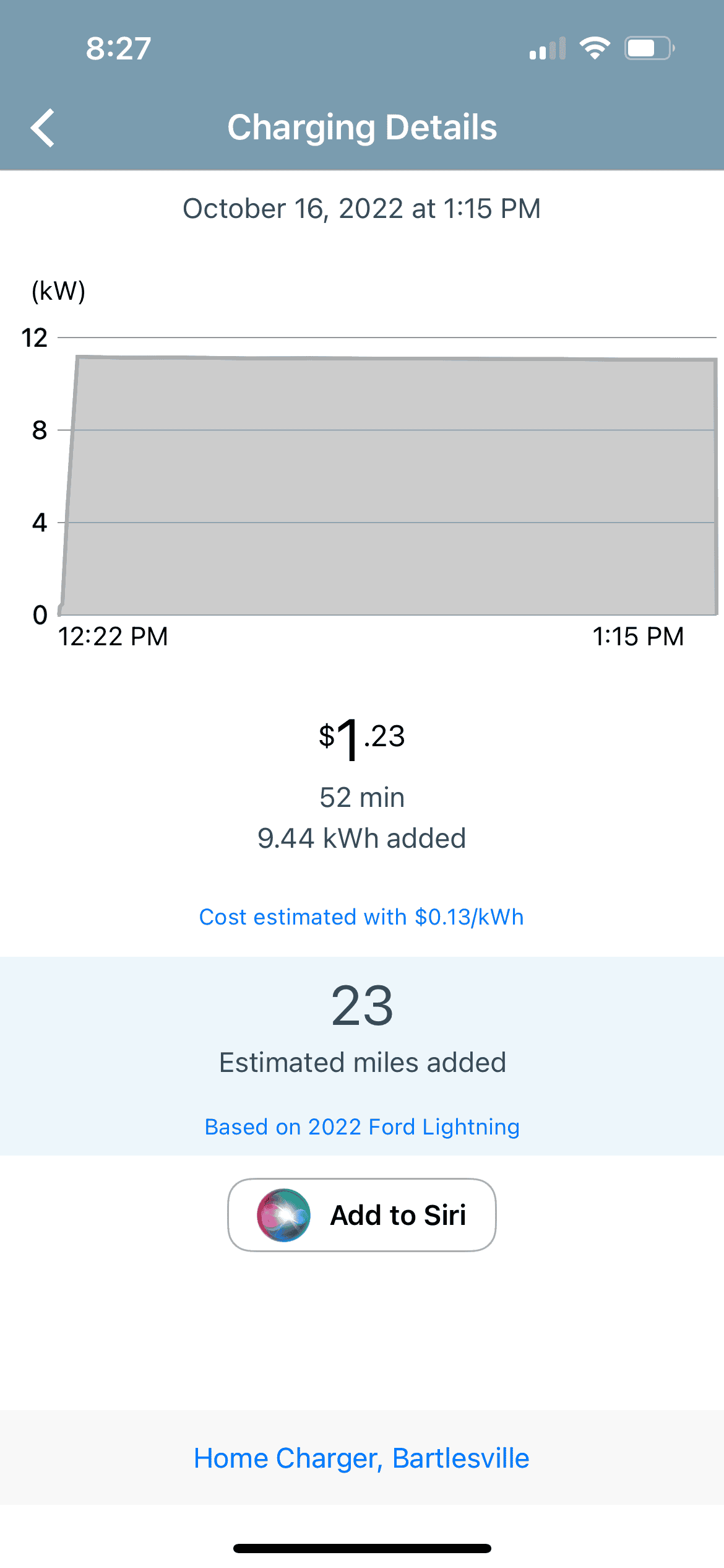

Ok. I haven't had the ping-pong charging again, but I did want to ask if this is normal for everybody else. It took 8 minutes to get to full charging current after plugging in. I take it this is normal for everybody else?
My XLT SR also takes a bit of time to ramp up. Hard to tell how long it is. Probably somewhere around 3 minutes?

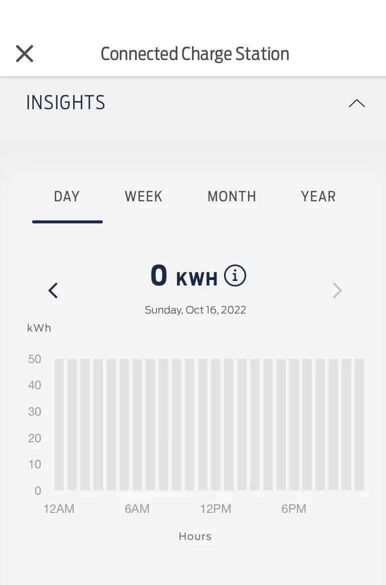

@Pioneer74 you’re lucky to get info. Here’s what Ford CSP gave me for my 5 hour charge session today

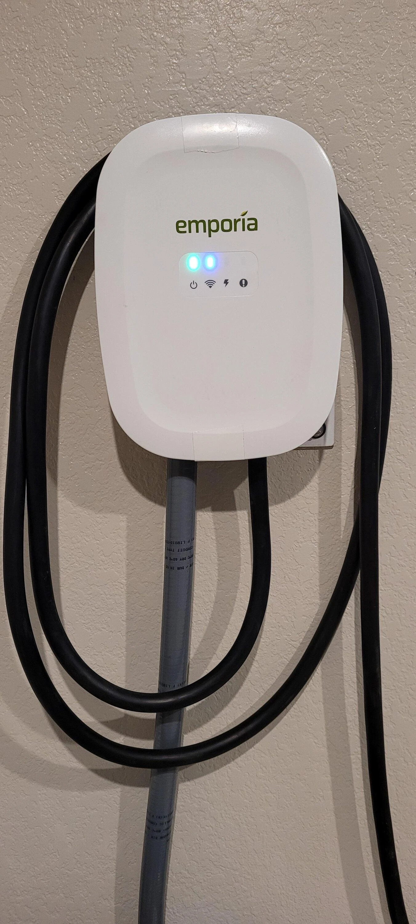

I might not even unbox my FCSP and just buy another Emporia for my wife's Mach-E. My only concern is getting enough range overnight in the dead of winter in my electric providers 7 hour charging window to cover my 100 mile commute.

I’m seeing the CSP shows the full kWh from your charge session all on the hour your session completes, which is when you unplug. Not very helpful.
Exactly what I have noticed

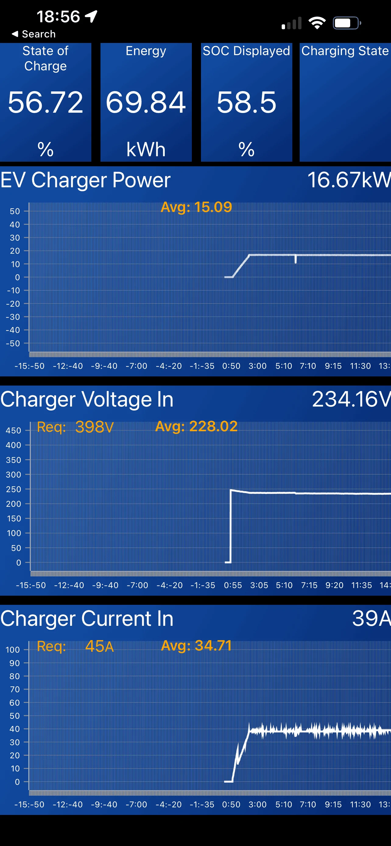

Here is what I recorded using CarScanner for one of my FCSP (240V/80A setting) charge sessions of my ER…….it shows my truck took 2-3 minutes to ramp up to the charger’s full capacity.
Graph Note: I’m only able to ID/monitor the amperage of one of the ER’s two onboard AC-DC chargers, but math ([16.67kW/234.16V]*1000) shows the 71.19A total being delivered at this point of the charge…..

Well, it's doing it again.

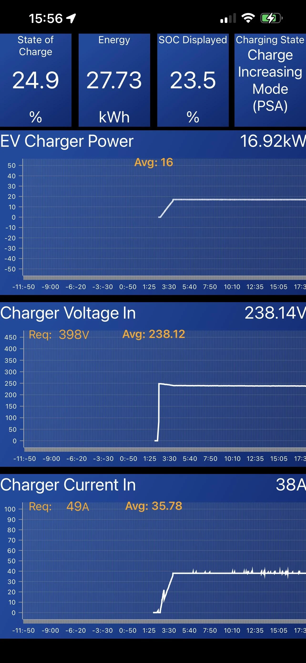

Hmm, frustrating I’m sure! It would be interesting to see what your truck is requesting vs what your charger is supplying. That may provide you a better idea where the issue may be rooted.
This is the beginning of my last 240V charge Thursday afternoon/evening on my FCSP starting at 20% SoC…I checked and it pretty much maintained delivery of 16.67-17kW until the truck reached ~90% SoC where delivery dropped precipitously…..

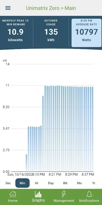

It's definitely not my charger. The previous 5 sessions before last night it peaked at 11 kW like it should.
