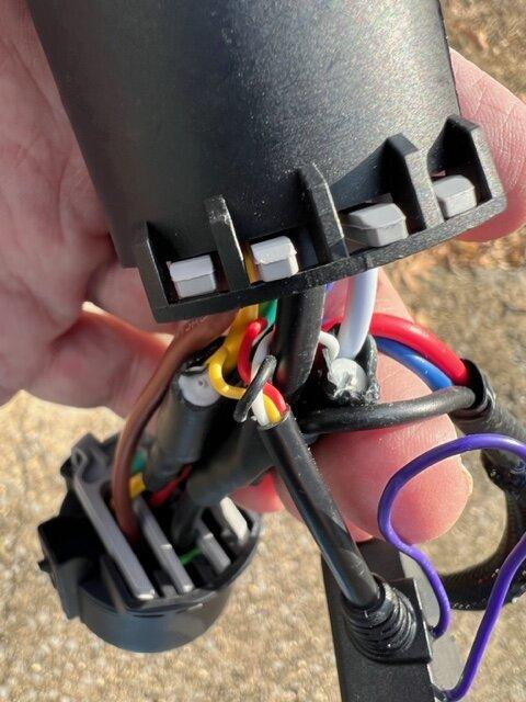

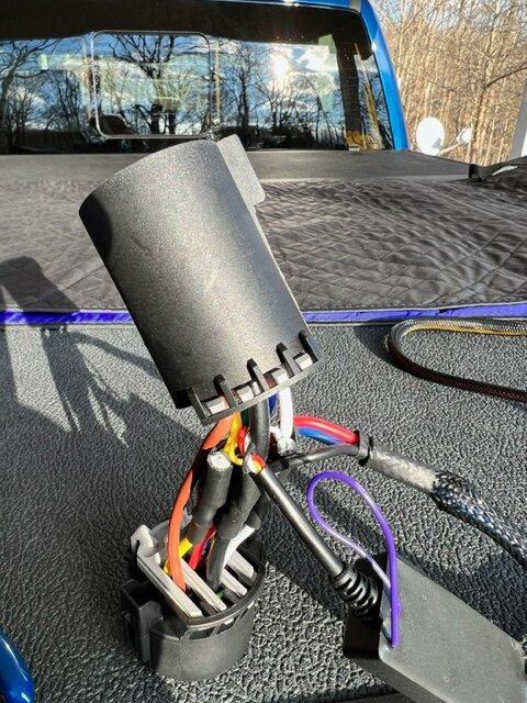

So I uninstalled the whole thing and took a look at the harness after unwrapping the tape.
Just to make sure I'm looking at the right thing....it would appear to me that the resistors in this harness have already been clipped. I peeled back the heat shrink a bit on the edge of the white wire just to make sure I knew what I was looking at. The one on the yellow wire clearly looked clipped without having to do anything to check it. There is a bit of exposed conductor bent over on the white wire resistor but it is cut and doesn't go any further than the heat shrink.
Ford F-150 Lightning NEW PRODUCT | Diode Dynamics HitchMount LED Pod Reverse Kit IMG_3553
Ford F-150 Lightning NEW PRODUCT | Diode Dynamics HitchMount LED Pod Reverse Kit IMG_3552
If I'm looking at the wrong thing let me know.

Looks right to me.
I just tested a C1R on my own lightning... AND it worked fine. No issues at all. In fact, if i pressed the trailer brake control button it said "no trailer connected" so not sure what's going on.
Diode doesn't know either to be honest. It's hit/miss it seems.
