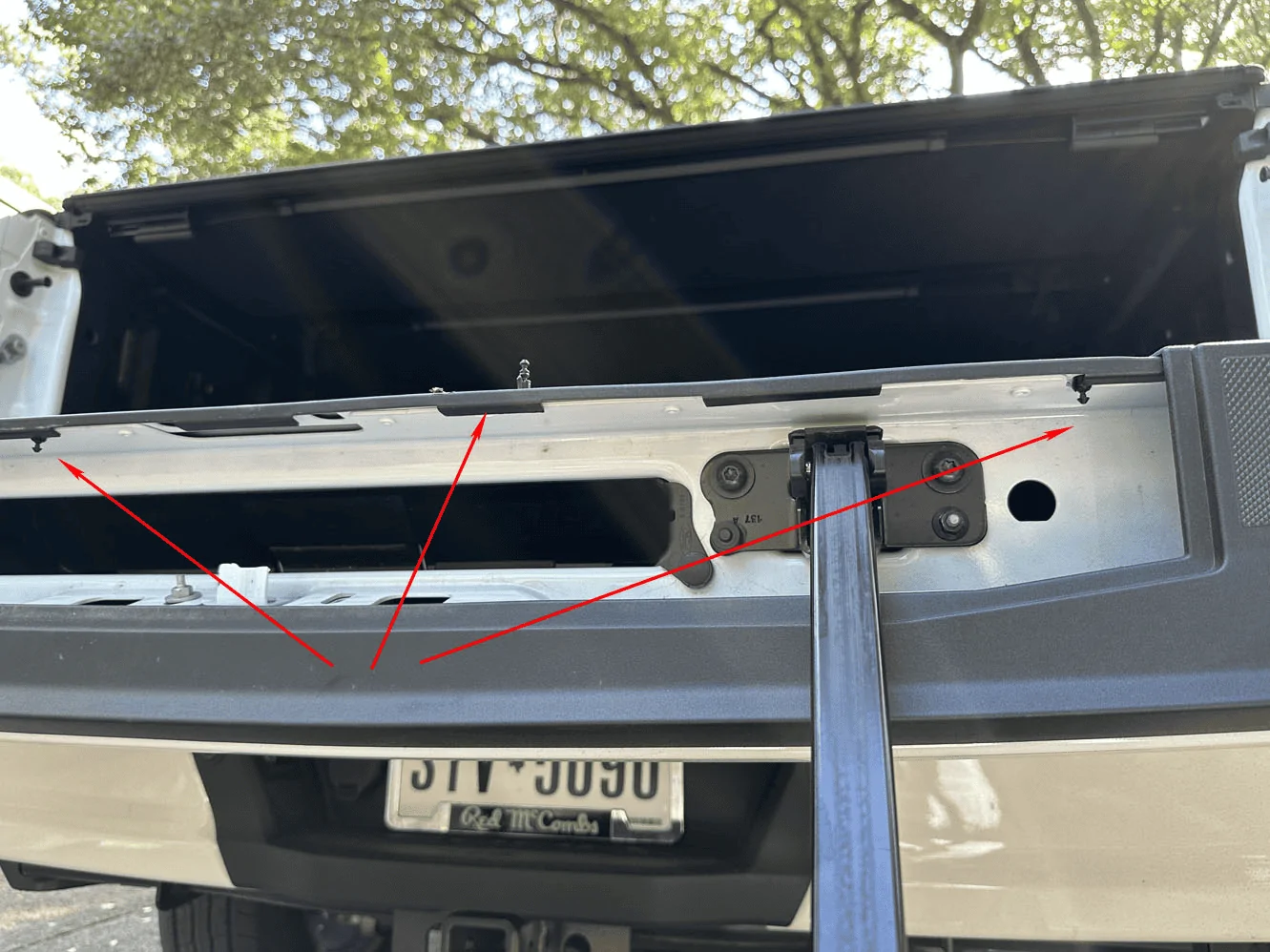

Actually, if you have a tailgate step, the clips are readily accessible without unscrewing or pulling out anything. And, likely, inserting and/or removing the tailgate step from the tailgate was the cause of the broken clip and bulging trim strip that I depicted in my OP post.

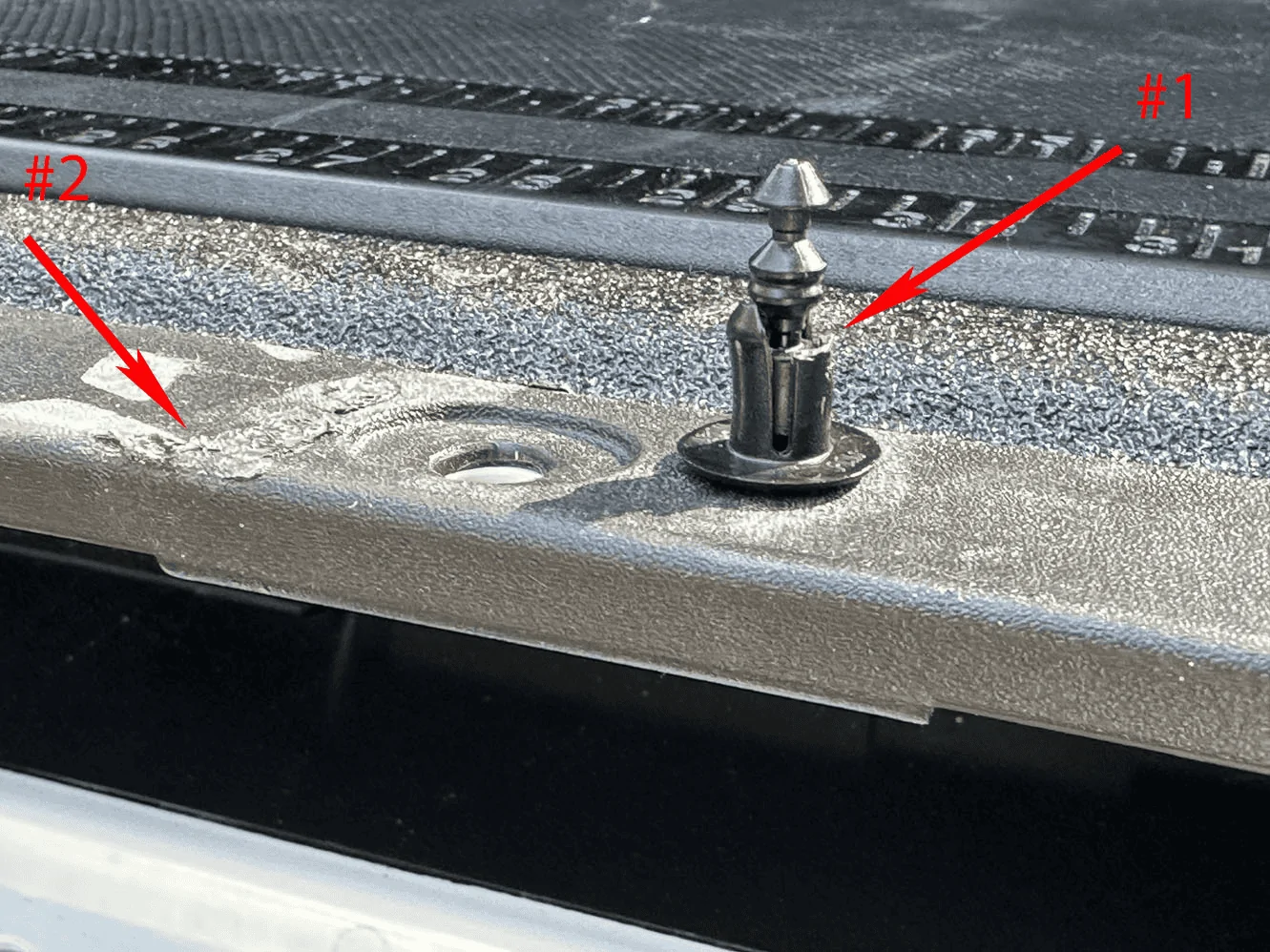

In the first picture below, arrow #1 points to a broken part of the plastic clip. Arrow #2 points to a gouged part of the plastic inner tailgate covering that some workers at a recycling center today marred while trying to unload a 150- to 200-lb piece of old scientific equipment (again, so much for Ford Tough - the plastic tailgate cover is made to fall apart eventually with real-world use and workers struggling with unwieldy items ...).
The clip is a pointy male part within a female part. The first picture shows the broken clip sitting upside down on the lowered tailgate. In "insertable" form, the male part is withdrawn from the female part so the flanges around the female part are resting along the male part in the gap between the upper conical section and the two lower conical sections. This allows the male and female parts to be inserted into the hole in the cover strip over the hole in the tailgate metal. Then when the male part (imagine it rotated 180 degrees and right side up) is pushed further into the female part until it's flush with the tailgate deck, the two double conical sections push the flanges out and lock the clip in the tailgate. Apparently, just having one of these flanges break off on the female part is enough to make the tailgate clip (and the strip it secures) come loose.
So, if I can buy an unbroken clip in "insertable" form, it should be easy to secure the plastic strip on the tailgate. I presume to remove a clip, with the tailgate step lowered, all one probably has to do is gently push up on the end of the pointy male part to allow the flanges on the female part to collapse into the narrow space on the male part between the conical sections.

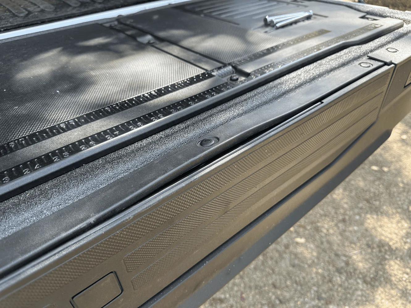

The second picture below shows the view of the top area of the lowered tailgate from below. The arrows point to the securing points for the plastic clips. There are flanges on the plastic strip that the clips secure that wrap around the sheet metal edge of the top of the tailgate and are perhaps designed to deflect the tailgate step downward so it doesn't clobber the plastic pins as you close the tailgate step. Guess it didn't work too well on my truck. Seems like a great Rube Goldberg design by FMC... ?
