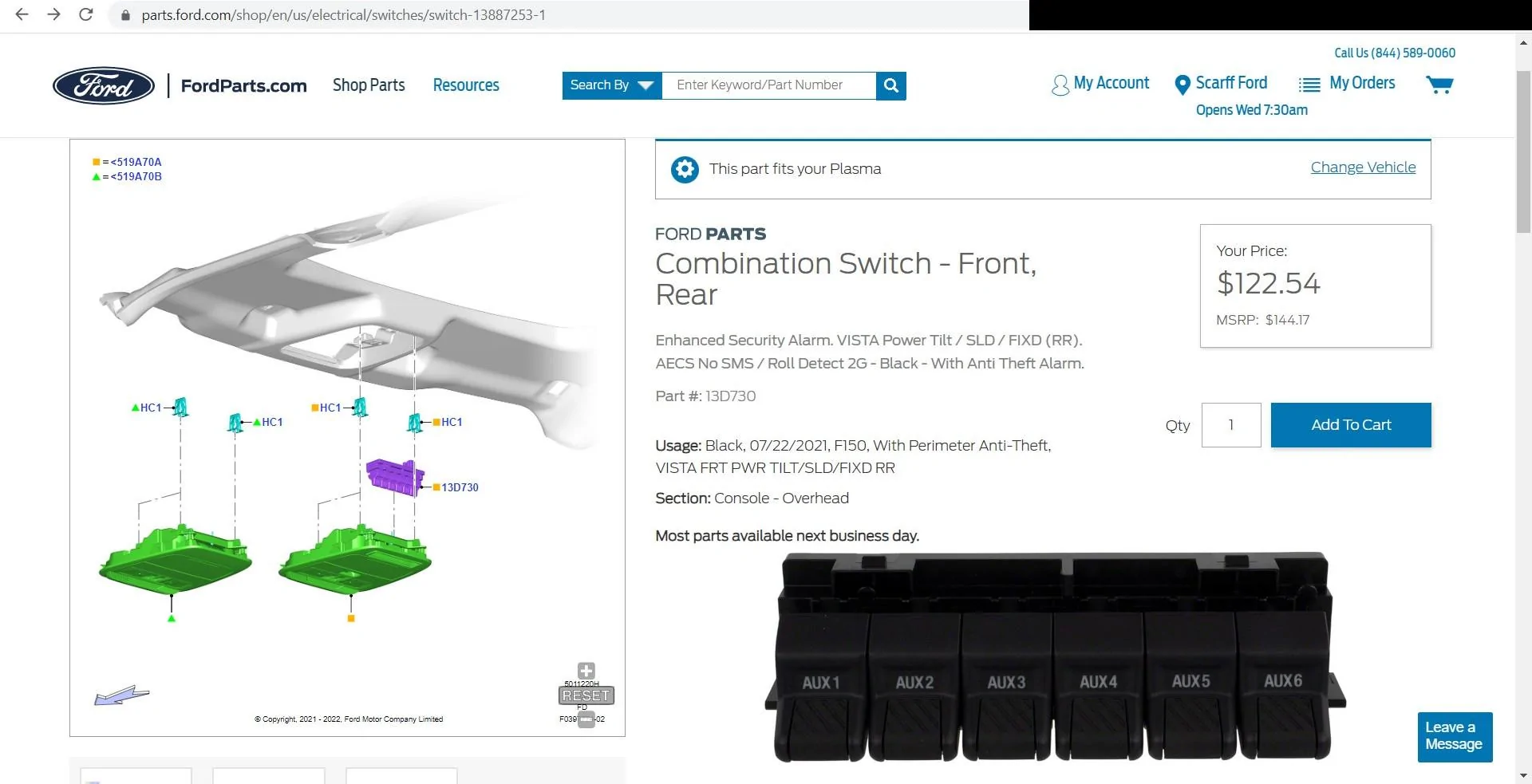

Has anyone seen or tried to upgrade with this OEM Overhead 6 Accessory Switch option? Either on the Lightning or any other standard F150? Here is a link to the part for the 6 accessory switch, but I could not find the housing(s). The overhead housing in my truck does not have the cutout for these switches, so I would need to also find the alternate housing to order. I'm not sure what sort of plugs nor how they are intended to be wired.
6 Accessory switch!?
* $123 https://parts.ford.com/shop/en/us/electrical/switches/switch-13887253-1
** Related housing 519A70A versus default without cutout for above switched 519A70B

I did it to my 19 F150. Really liked it because it was clean install. I bought the upfitter console and under hood box from ford. Got the wiring harnesses from a guy that makes them just like OEM. Those component won’t work for the lightning though. I set mine up to run front and rear lights on via the switch or via a relay when highs or reverse went on they would automatically activate I could also deactivate that feature via another switch. Also had a flashing beacon so I could drive around on airports.
The switches you show won’t work without something to put them in (the console) and are only switches so you must have all the relays for the power. For the lightning I plan on building one but will just use a small pelican box under the hood with a main fuse and all the components. They have some pretty nice lighted switches that are way cheaper and can be mounted to a braket In the center console.

Thanks for sharing your first hand experience in your 2019. Ya, I found the oem part interesting because it would be a super clean factory looking install. Haven't decided if/why/what I might want to use it for yet though. I like the idea of keeping the truck mostly stock, for now, but also enjoy exploring potential projects as well.
