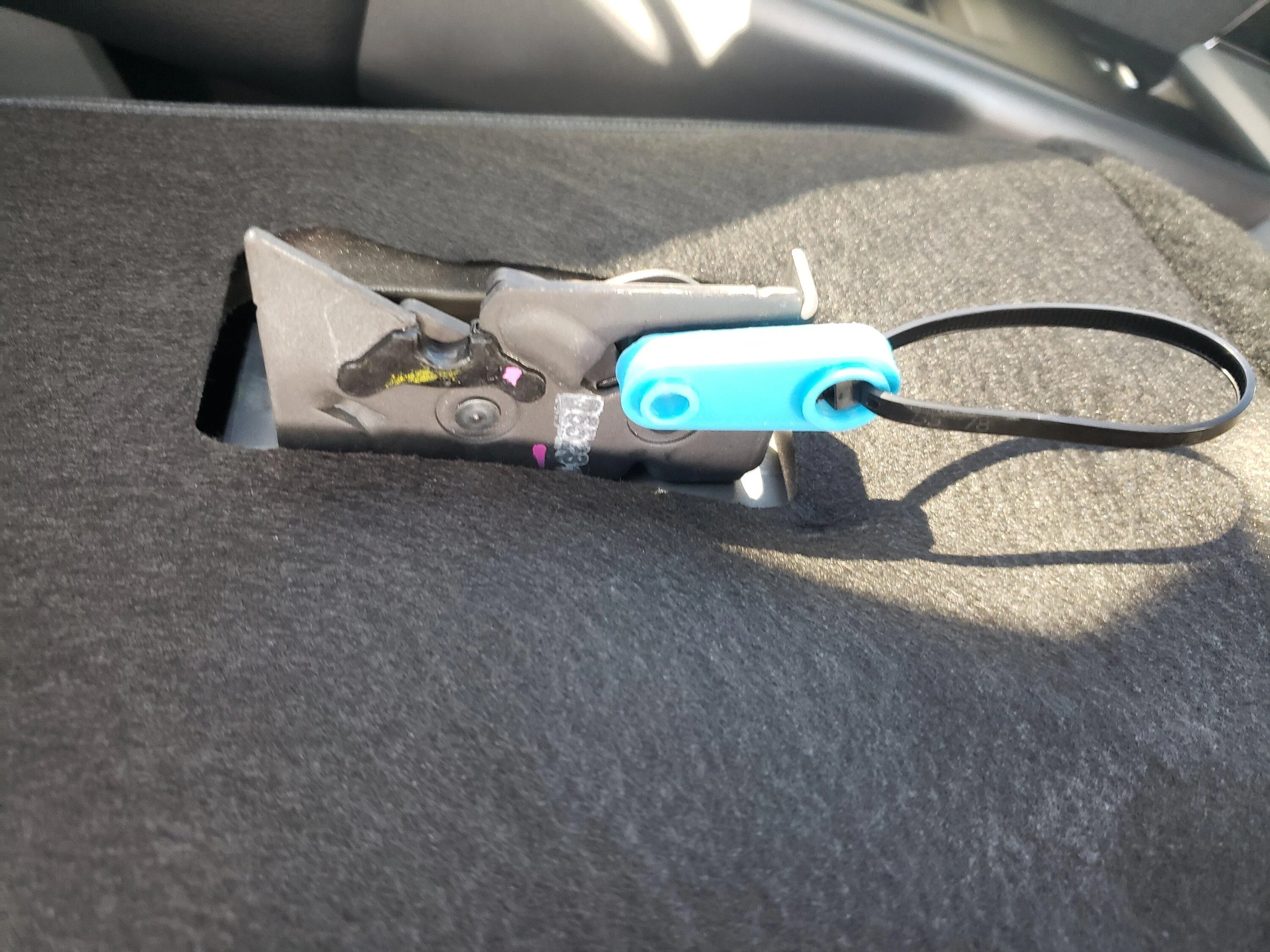

1. Release the lower seat lift up a little
2. Using a wrench reach back and pull up the nub on the latch.
3. I 3d printed a piece to attach to the nub, this is only a first edition will make changes and a better strap
Close back and then lower bottom.
This is only a test as there is a part that can be purchased for $40 but its not needed.
Time to work on a better strap as I thought I had some paracord but could not find for this picture.

I don't understand what I am looking at here. Is this under the drivers seat?

Click Rick’s link. It explains it all.
OP, in step 1, you do not need to “release” the lower seat to lift up.

This is behind the upper part of the seat. The passenger side has a strap to access the jack. But drivers side does not have a strap, unless something is done.

OP, you do not need to “release” the lower seat to lift up.
I found it easier before adding the piece, when you life up the bottom it creates more of a gap so you can look down and did the nub to hook the wrench onto. But yea once it is set it no longer needs to be done.

Sorry, I agree lifting the seat makes it easier. I’m just saying you don’t have to release it to lift it. You just lift it.
Your step 1 should just say “Lift the lower seat bottom a little “.
Guarantee someone will ask how to release the seat bottom to lift up. The release tab on the bottom seats is only to lower, not to raise.

I bought the Builtright device on Amazon. Just installed it last week. The problem with using the wrench head was all I could feel on mine was the rivet at the top of the slot and not the latch bar. I cracked the one on the passenger side and looked at where/what I needed to move and them managed to reach down blindly and find the latch bar and pull it up. And you will never reach it if you don’t lift the seat bottom up to slightly tilt the seat back forward. Once you have it open it easy to understand how it works. A piece of paracord and wooden handle at the top to keep it from falling behind the seat back would work but the Builtright is a more elegant solution.

The straps on the back are for car seats.
