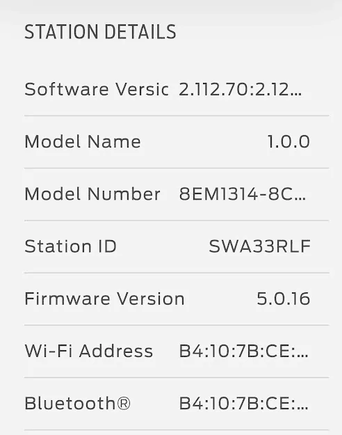

Prior to getting a range extender, I had a very weak signal, WIFI signal limiting though put to about ~ 15 mb/s but I was able to get the updates over the course of a couple days, as signal strength varied. I think when I left the garage door open it helped.
Another quirk I noticed is that it can take 60-120 seconds sometimes more to connect to the FCSP setup utility, this is slow even now that I have the signal extender pushing out 750+ mb/s in the garage.
I looked recently and this is my current patch level
