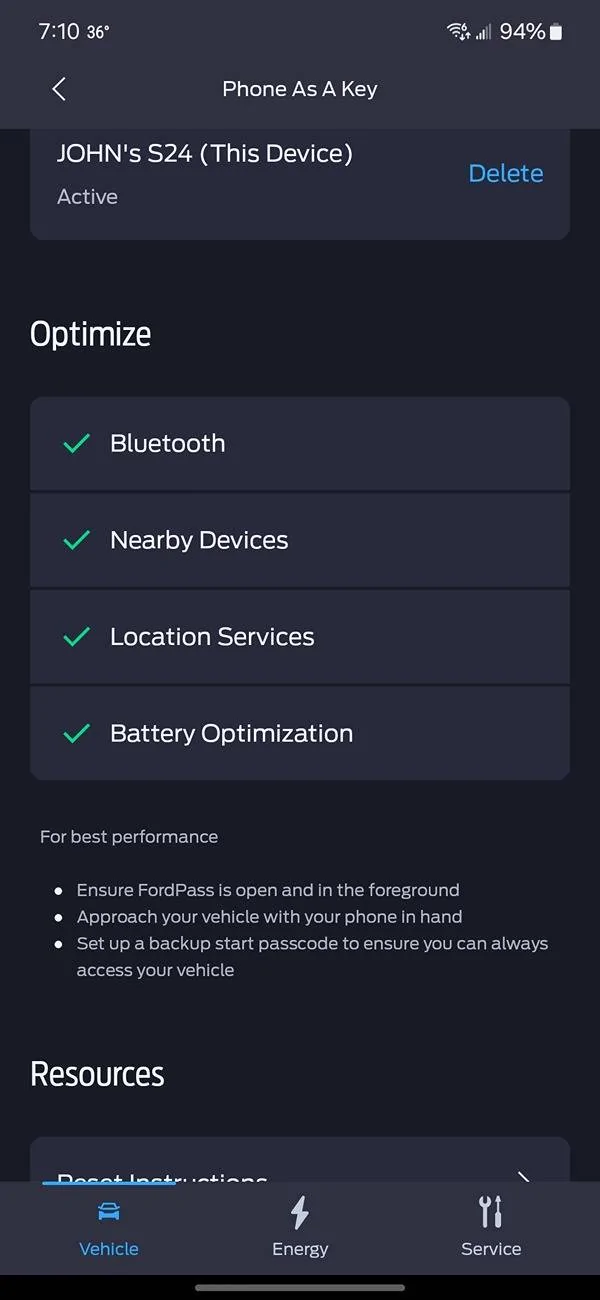

What kind of phone are you using?
Is the phone optimized for PaaK?
iPhone 16 Pro—never had an issue until two weeks ago. Yes, all settings are optimized. If I open the truck manually, PAAK works fine to start the vehicle. However, when I leave the vehicle and lock it, as soon as I close the door, the vehicle starts honking and reopening, thinking the key is left inside. I have to lock the vehicle using the keypad
