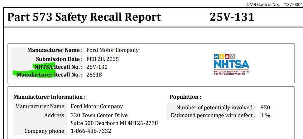

This appears to be a different recall than mine 25V131. I've never seen your recall.
Is there some confusion between the NHTSA tracking number and the Ford Recall number, they are the same issue.
Thanks. I didn't notice that. I was just referencing the number at the top of my recall sheet. When I saw your number I assumed it was a different recall.
