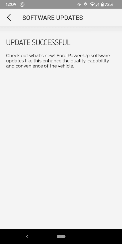

So this may sound like a dumb question but how do I know what update version I just got?
There are no numbers to say what version I have that I can see.

You are a job 2 truck. The update you just got was for bluecruise only. The only OTA sent out so far for JOB 2 is the one you just got. The apim software version is only referring to the apim. That version was the version shipping around july/august.. then 21223 started in October or so
