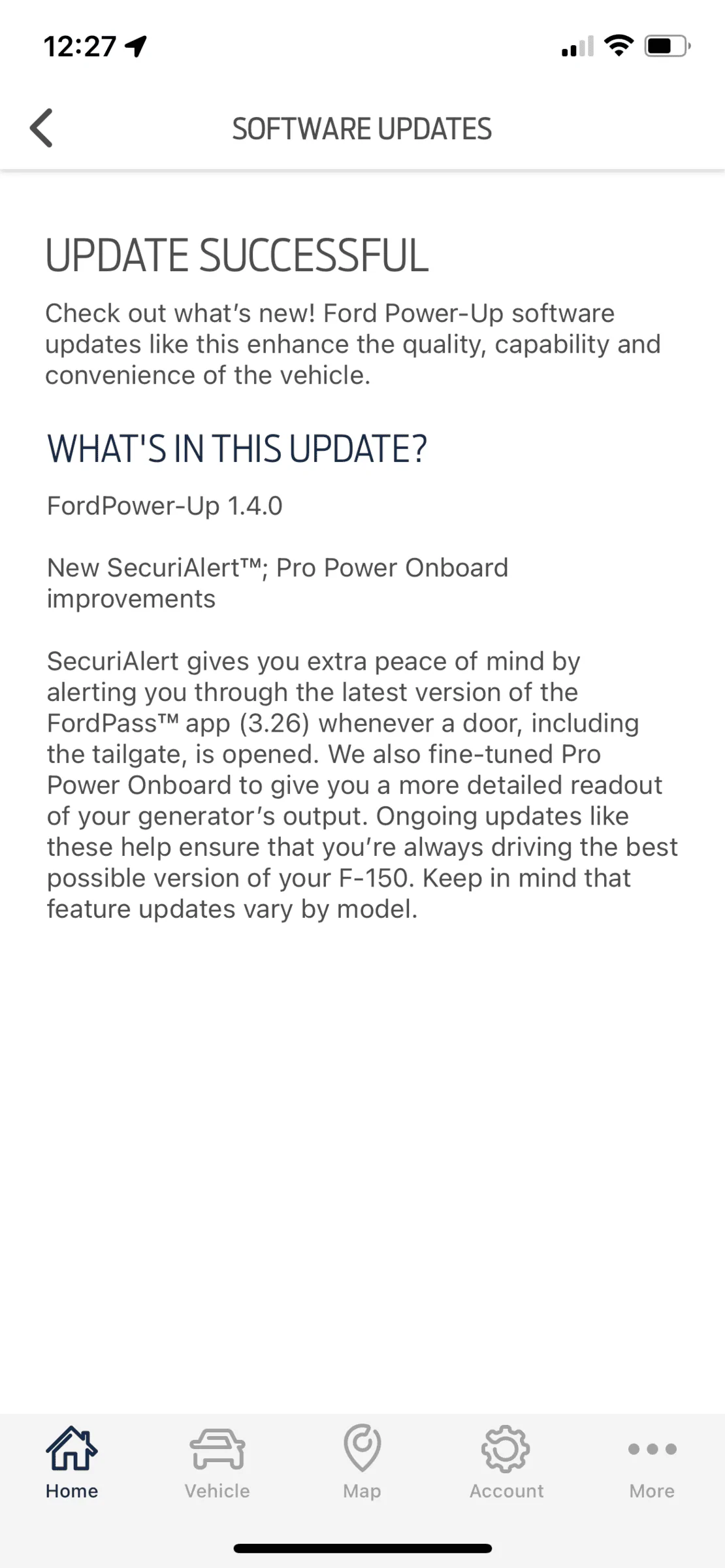

I just received my update was installed on Ford pass app last night
why does mine only say 1.4.0 ? seems like that's an older update?
I read about changing from auto update to scheduling an update. So last night I scheduled an update for 11pm and sure enough I received 1.6.0
So that was nice to see. I know Im way behind still but Ill keep scheduling the updates every night and see if they keep coming.
