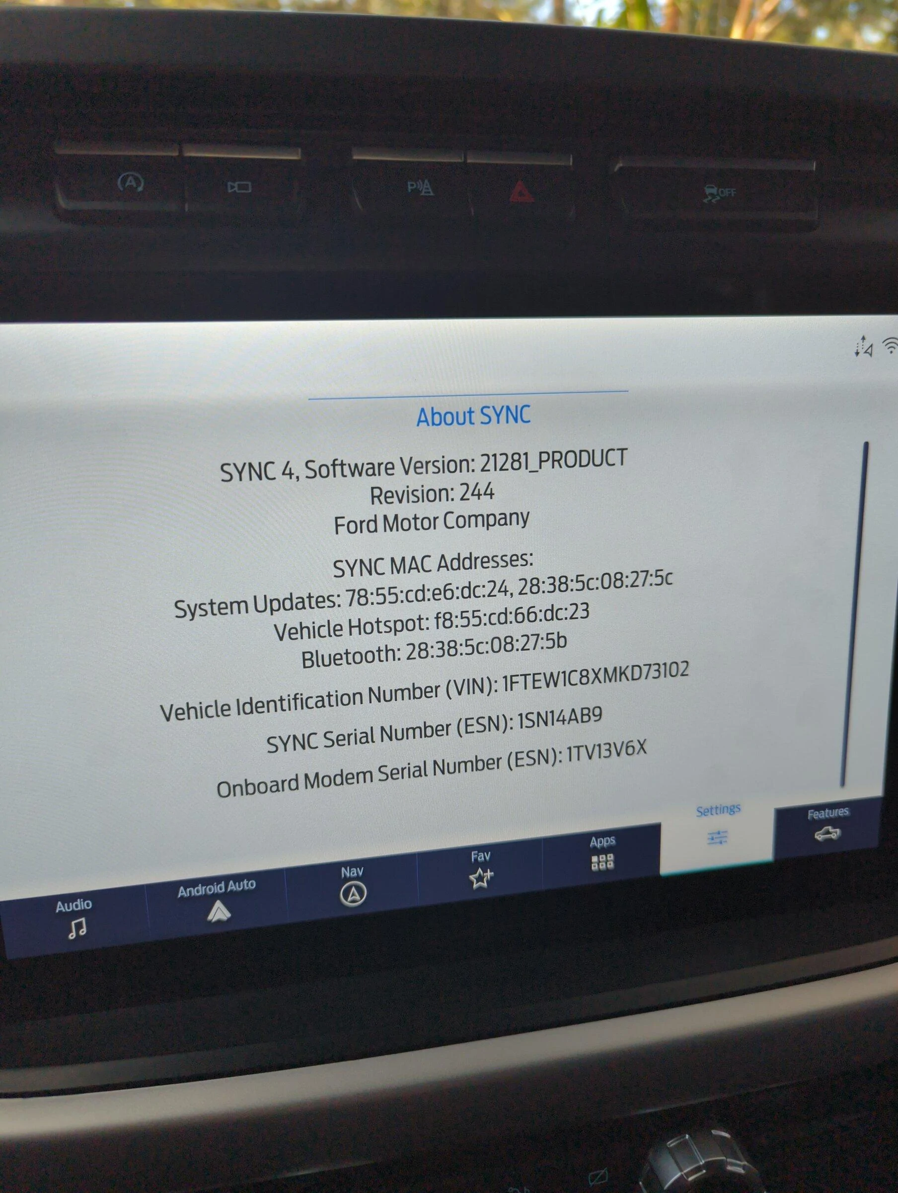

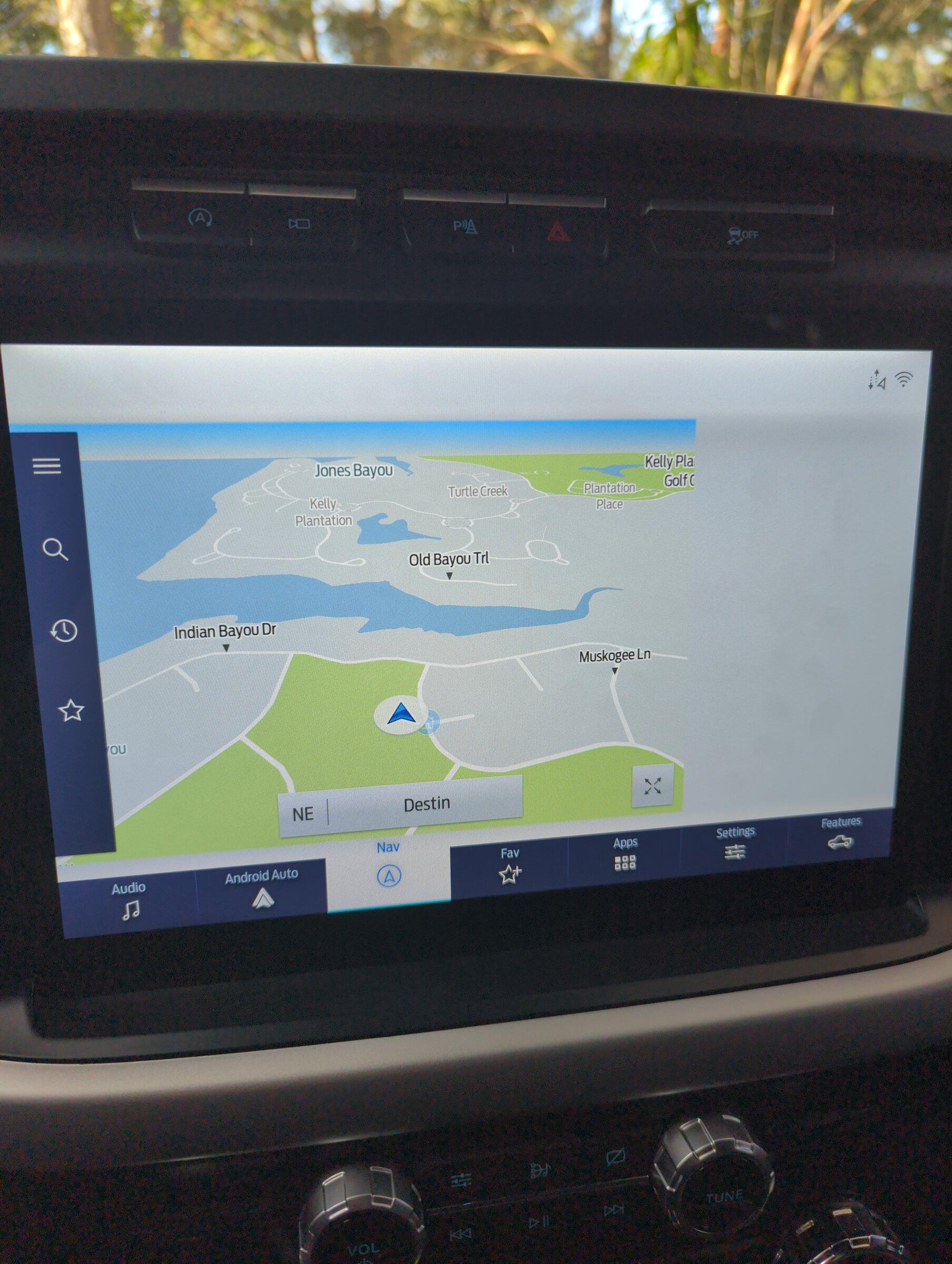

First, thanks for the great guide on these updates. I was able to update my modules, but seem to have an issue with the Sync display now. The screen graphics now seem to be misaligned and don't display correctly. For example on nav screen the right app screen is completely missing, also on the top my clock and phone list is missing. See attached.

Man.. that looks like it loaded the wrong files. That’s the 8” screen. The crazy thing is the 8” and 12” files are identical. But it is supposed to load the proper ones for the correct apim.
