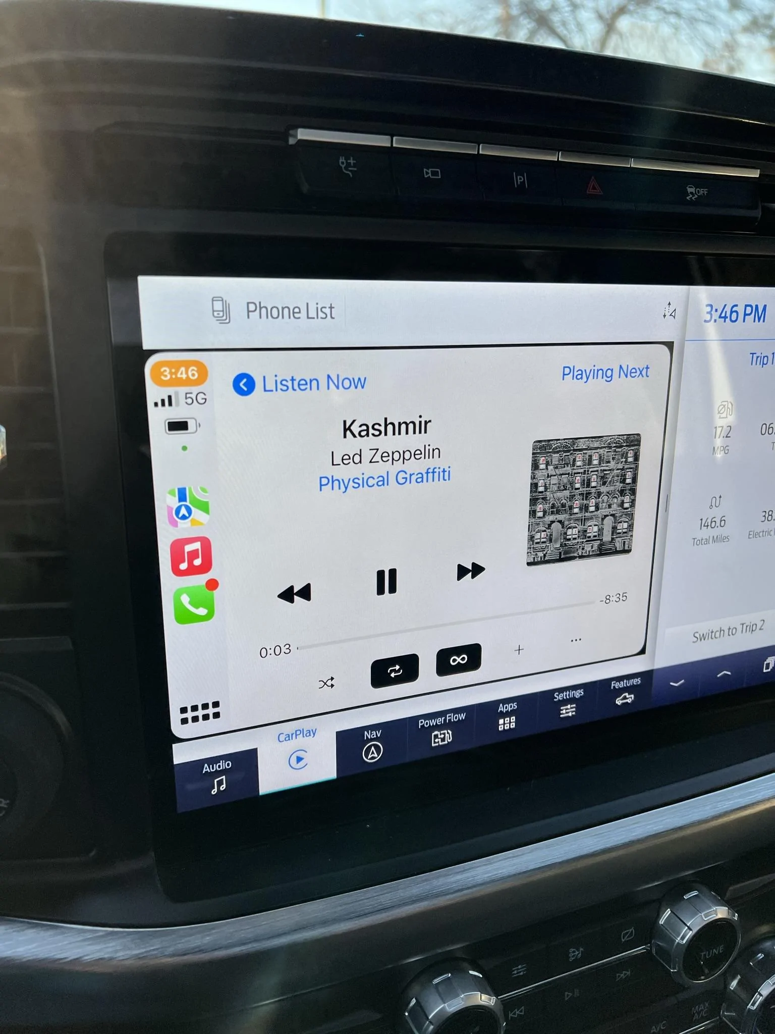

Can you post a screenshot so I can compare ? Also, what version of sync are you running ?
Sorry I’m just getting this out now. I’m pretty sure I’m on 2.0.0 sync, and his is iOS 15.3. The black outline has been there since I got the truck as far as I can remember.
I assume Sync does not show version and your OTA buttons are disabled.
You can check SYNC version in General -> SYNC version (scroll down)
