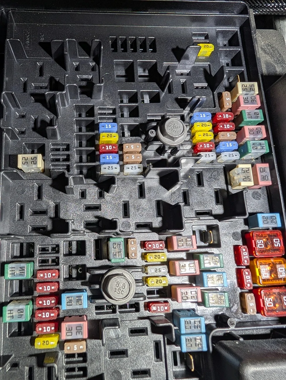

As of Friday (28 Aug), the service writer says that they replaced the wiring harness but it "blew a fuse"....not sure what fuse that would be...and that would indicate a short! Not good! But he said they've decided to replace the "fuse block" and a module. Of course we're not getting specifics here and maybe not the proper nomenclature. Maybe (from the drawings referenced previously) the "generic function module GFM3"151-8"? as it's labeled 7.2 kW? And maybe the rear H.V. junction box?
I really don't know....but he said they should have the parts by Monday. I'm crossing my fingers.
OMG...what a mess.
Blown fuse = short circuit somewhere, a short to ground.
That's a new wiring issue isn't it?
No fuse blown before, right?
Good grief!

Yes, I didn't find any blown fuses previously.....though I didn't check every one. So yes, I hope they're not creating problems! But again, I'm not sure the communication between the tech actually doing the work and the service writer is always accurate. I really hate not knowing what is REALLY going on. It's so hard to leave things in someone else's hands.....I so want to be involved!
