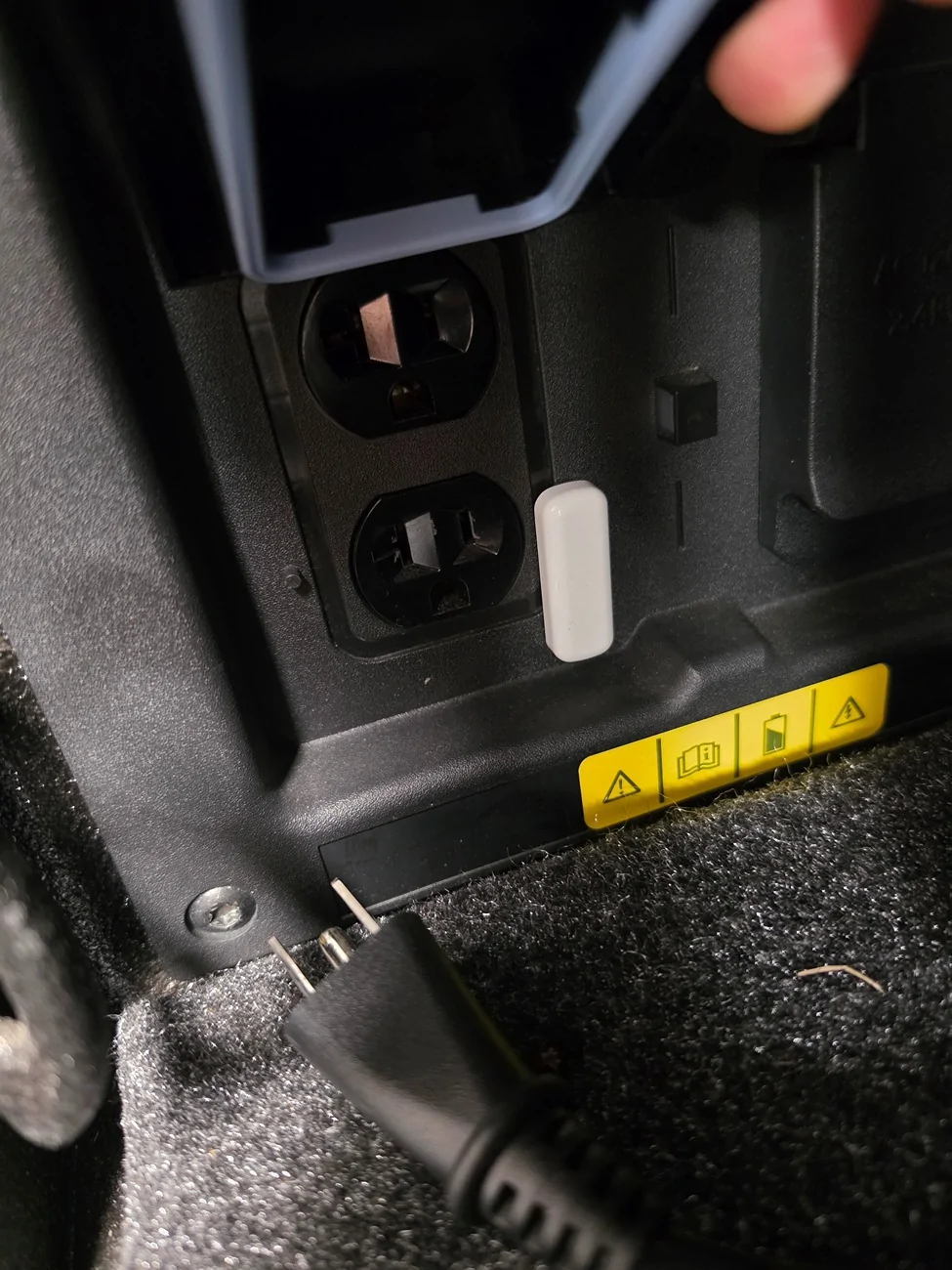

I just tried using my 120v outlets for the first time while driving but didn't know there was an inhibit set when the outlet cover is open. Is there a way to use the 120v outlets in the bed while driving? I was trying to use a boot dryer while driving back to a hotel from a soccer game. The truck posted a message and would let me shift out of park.
Place a small magnet just to the right of the bottom outlet. This will allow you to shift without that annoying alert.
