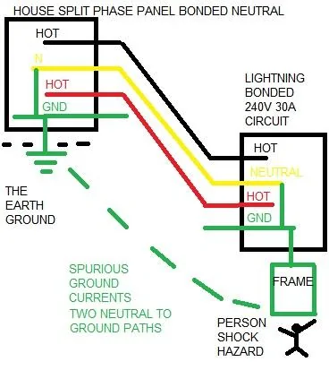

Ford F-150 Lightning Pro power GFCI issues LIFTED GROUND SHOCK HAZARD
I drew a diagram to explain how there could/would be a path to ground through your body - something you want to avoid. I actually read a post where the owner got a shock from touching the frame and I drew this to explain why what the electrician did, lifting the ground, was bad practice.
The transfer switch, when connected properly, will disconnect the neutrals from the ground bond at the service panel and ground them to the generator/Lightning ground when using the generator/Lightning - they will remain grounded through the service panel bond when using utility power.
BTW, like when powering a sub-panel in an out building like a shed, having ground rods at both ends is good practice. There are already ground rods at your main service panel. Having a ground rod connected to the frame at the generator/Lightning as well, which is the source when in use, would be a good idea, in my opinion. As long as the neutrals are switched, there will not be a problem with GFCI tripping. Ground rods at the generator/source provide an extra degree of protection for the operator.
