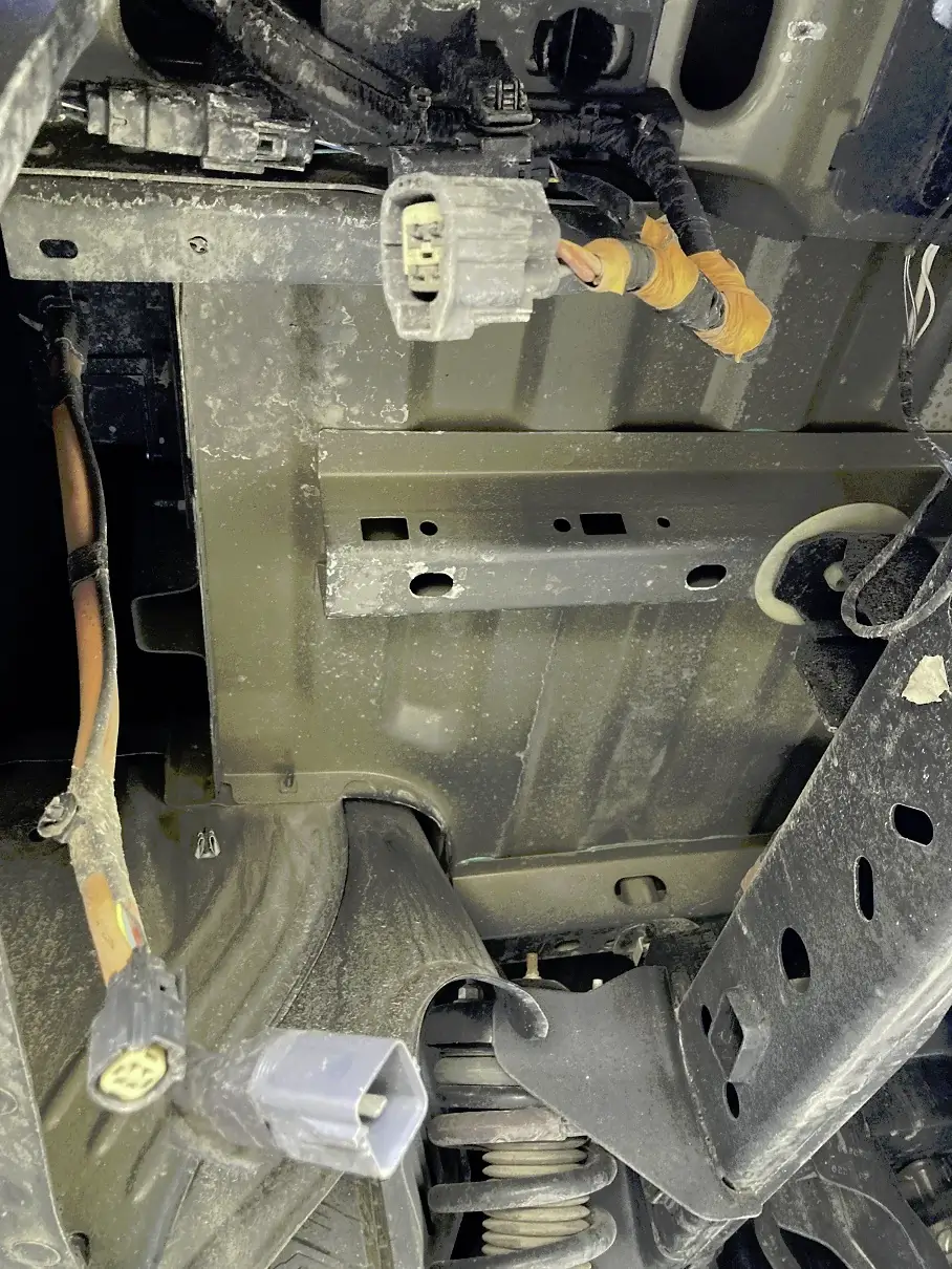

Does anyone have a diagram or pictures of these connectors? I was having this exact problem about a year ago… dozens of errors and then nothing for days or weeks and then another random burst of errors. I always assumed it was a loose connection but every time I was about to head to the dealership the problem would clear. Haven’t had it reoccur in months.
thx
thx
Might be this one in this thread:
https://www.f150lightningforum.com/forum/threads/unplugged-wiring-harness.34872/#post-646432
